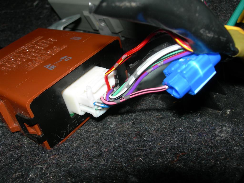

no need to tear the dash apart.. the tpms module is attached to the inside of the panel just below the glove box... all you have to do is ground one wire and no more light.. i believe it is the pink/black one... i will have to look again to be sure

here's the pic

this will permanently disable the light. use at your discretion.
use a scotch connector to tap into the PINK/BLACK wire. do not confuse w/the pink/blue one.
run a new length of wire and ground it to the body.

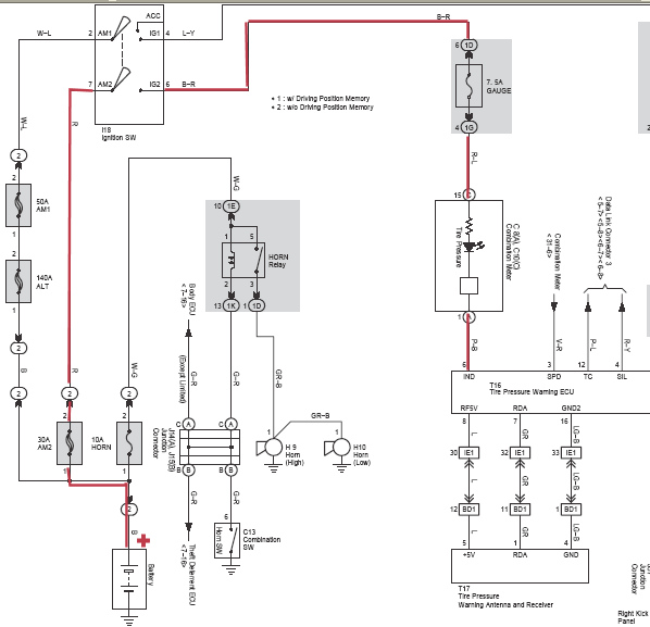

I would be interested if this works. From the schematics it looks like grounding this wire would cause the light to be on always and would also ground an output of the ECU which could cause a current drain that would overheat the ECU.
my understanding is that the wire when grounded turns the light off.. if you have the diagram, attach it. it will help others. here is where I started, and it works

Here is a copy of the schematic. I have highlighted the path from the positive battery terminal through the diode on the instrument panel. As you can see it appears grounding pin 6 of the ECU should make the light stay on. Since it turned the light off, the only explanation I can suggest is that it burned out the diode due to a reduction of the impedance through the ECU which increased the voltage across the diode. Your reference to the Tacoma seems reasonable but maybe their circuit is different. The schematic shown is for the 2007 4Runner and I verified it is the same for the 2006.

Rook, have you disconected the splice to see if the diode actually burned out?? I want to shut out that annoying exclamation point! I'd rather not burn a diode out permanently.

this mod is reversible. i have since wired in a switch which allows me to use the system half the year.

the module should be below the glove box. there are 2 screws holding the black plastic panel in place, drop the panel and it should be there
