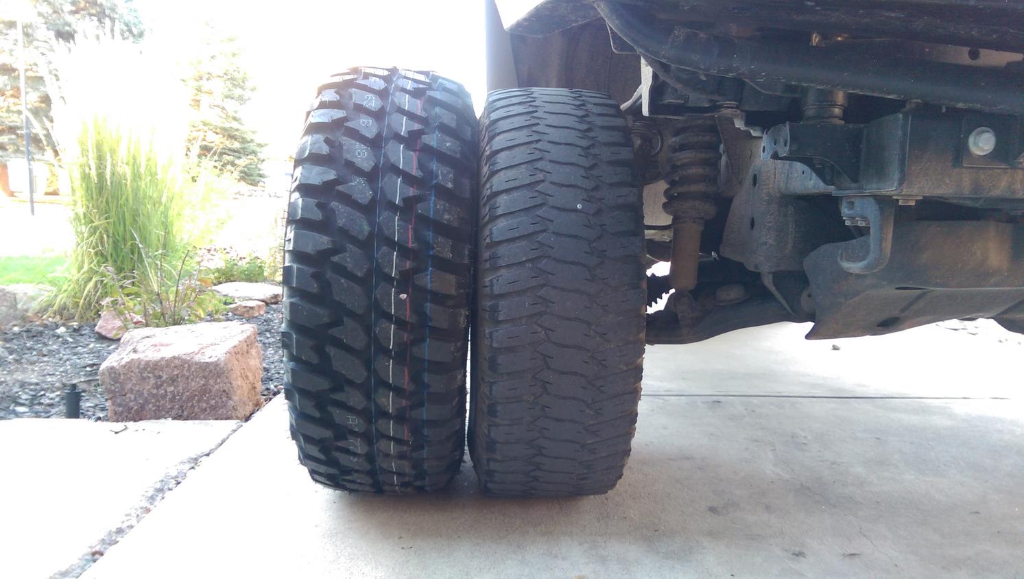

If it was me I would go with 305/70r16 like I did. They are almost as wide as a 35 but sit 33" tall.
285 vs 305.

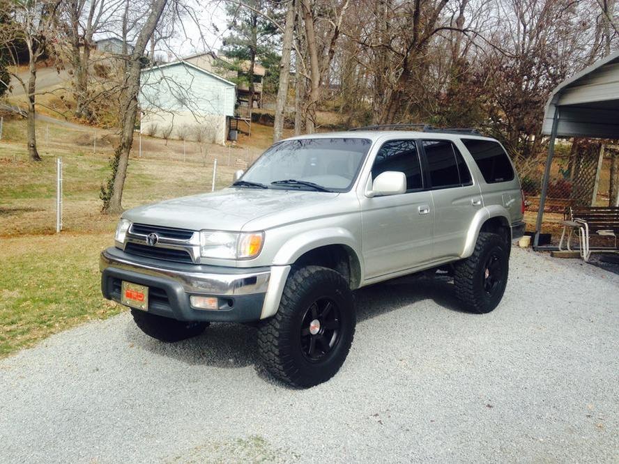

Toytec Ultimate with 891's. 255/80r17 BFG KM2's and I love them. Drives great.
