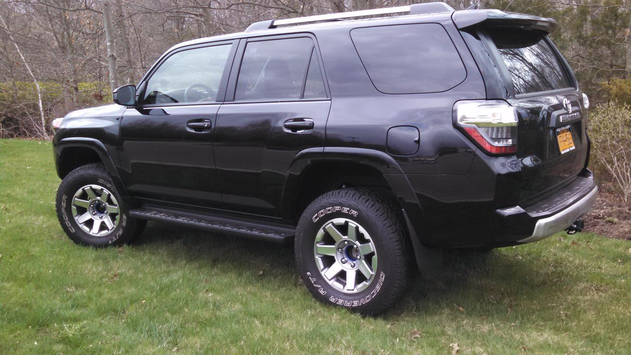

I went with 275/70/17 C load in a Cooper. No big hit in the weight department or rolling resistance. Big gains in stability over the P rated IMO. Tires were the first thing I did and nose dive under breaking essentially disappeared. Boss Toytec up front and SAW with Bilsteins in the rear.
Beauty is in the eye of the beholder I guess. I like my setup. Not much Off-roading in these parts. Everything I do is down at the beach running Democrat Point to fish and surf… a sand buggy. Other than that it’s a marina and Home Depot mule. A good looking mule though.
