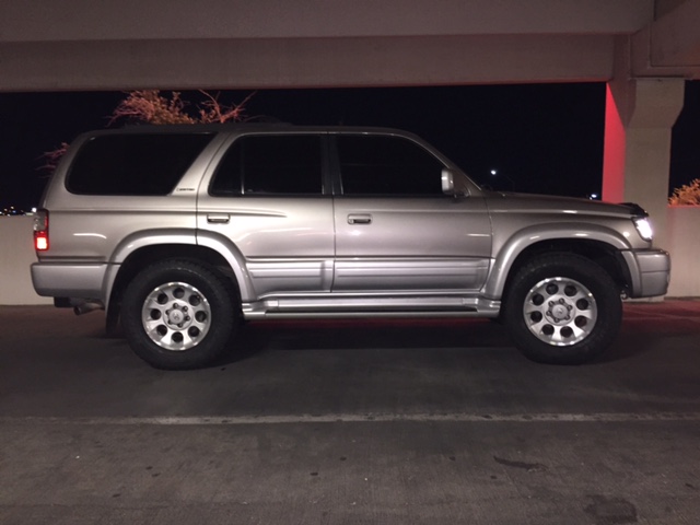

I just did an FJ 17" upgrade on mine with some new hercules tera trac ii tires. I really like how it looks with the wheel/tire combos!
