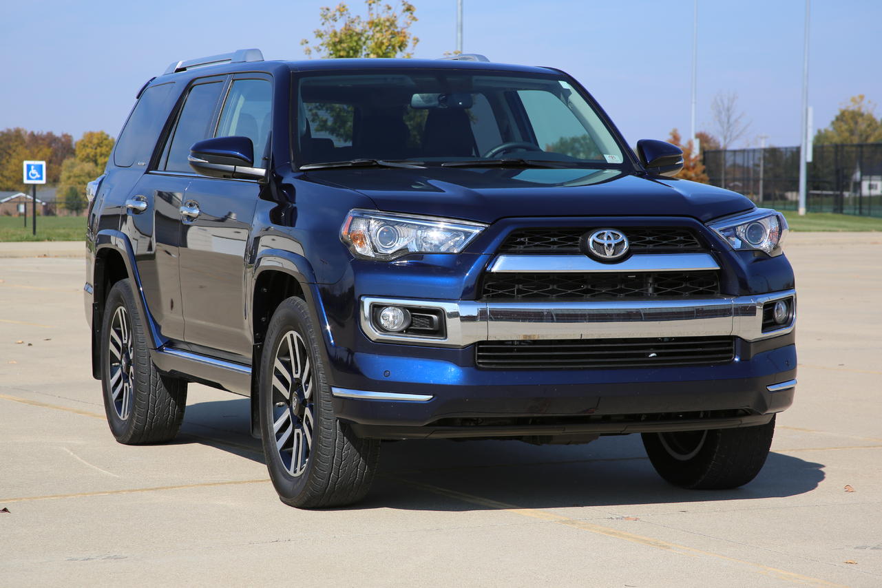

Hi Guys,
Picking up a 2015 Limited in the next couple of weeks. Just waiting for it to show up. I found that the 20's aren't prevalent in stock size. I've read that I can go up to a 275 (more common), but I think that for the sake of convenience and future tire $$ savings I might just step down to the SR5 17" rims. This brings a couple of questions:
Will this look bad on the Limited? Overall, same vehicle, I know, but the limited has some extra trim pieces.
Will the resulting effect of having tires with a taller sidewall (more opportunity for bounce/roll) have a noticable impact on handling? I love the way the limited handles as-is.
Has anyone else done the same thing? Did it make a difference in ride/handling?
Is anyone interested in my 20" rims and tires if I go this route?
Thanks in advance for any help!

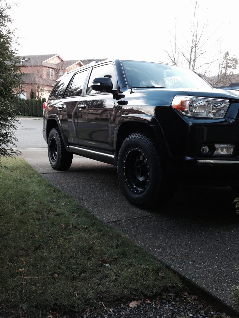

I dropped to 17" Method Standards on my wife's Limited and like the result. No issues with ride, if anything it is better with more tire sidewall.

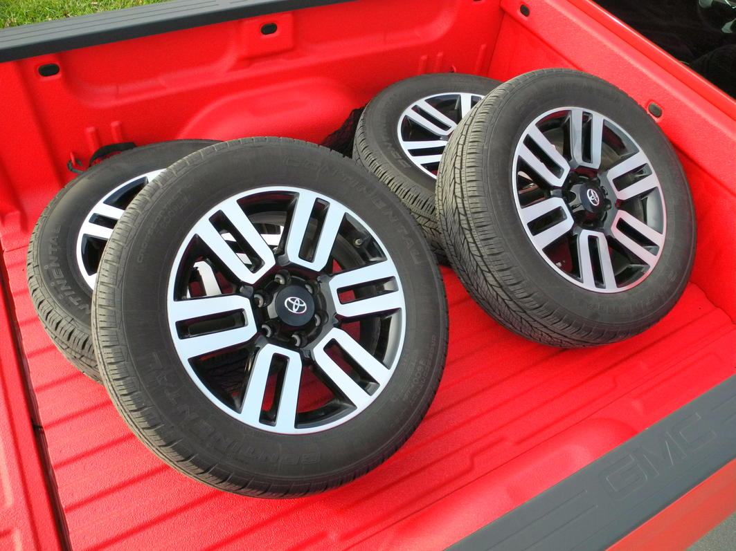

I just replaced my 2015 Trail Edition wheels and tires and been kicking around the idea of selling mine. They have about 600 miles on them and are like new. They have the sensors too. PM me if you're interested. I have no idea how much they're all worth. They would definitely look great on your limited.

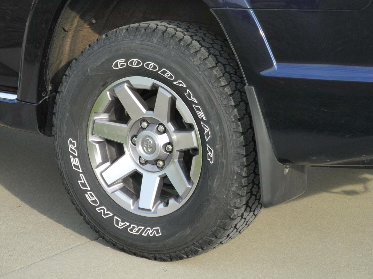

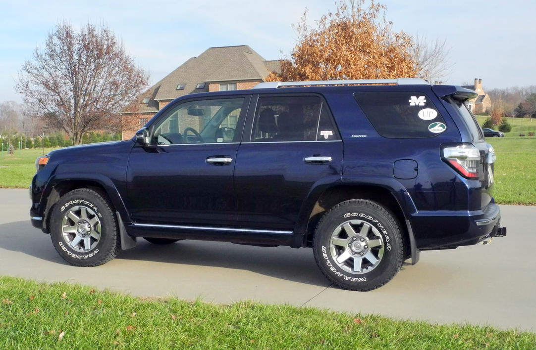

I chose a set of the 7 spoke 17x7.5 wheels, actually off an FJ Cruiser, and donned a set of Goodyear Wrangler AT Adventure with Kevlar tires in 265/70 R17. I have only the trip up here to Houghton to speak of so far, but (1) they're quiet on dry highway, (2) they did not hydroplane at 68 mph in the light rain across Wisconsin, (3) the mpg for the 750 mile trip up here was 21.2 (winter 10% ethanol), (4) they HANDLE very nicely on dry surfaces; cornering is distinctly more stable with less roll, (5) they STOP and TURN in the snow up here [our base is over 20" now] MUCH better than the Continental Cross Contacts they replaced (see comments below), (6) unlike a Blizzak, etc, they have a 60,000 mile treadlife warranty.
I could go on forever but I'll close this entry with some photos if I can technically do this (this is my FIRST entry on the forum). I am very much sold on this tire / wheel combination.
THE PHOTOS: (1) and (2): The finished product and a closeup of the wheel / tire. (3): An intermediate stage shot from last summer with my 275/55 R20 Continental Cross Contact LE 20's. (4): A shot "just left the dealership" with the running boards still attached and before I put on mudflaps and the Cross Contacts. (5): Then a shot of my 20" LE wheels with the Continentals sitting in the back of my awesome Sierra.

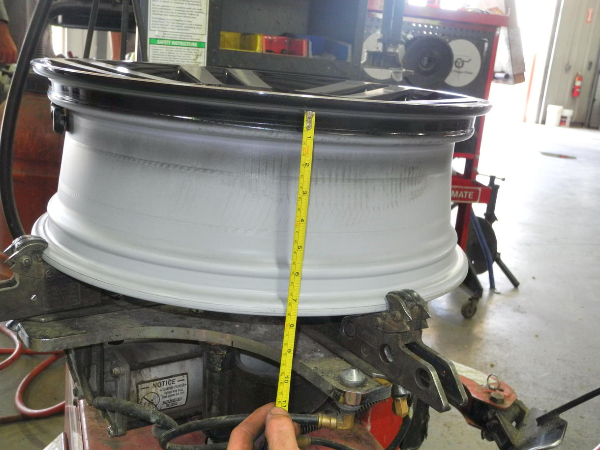

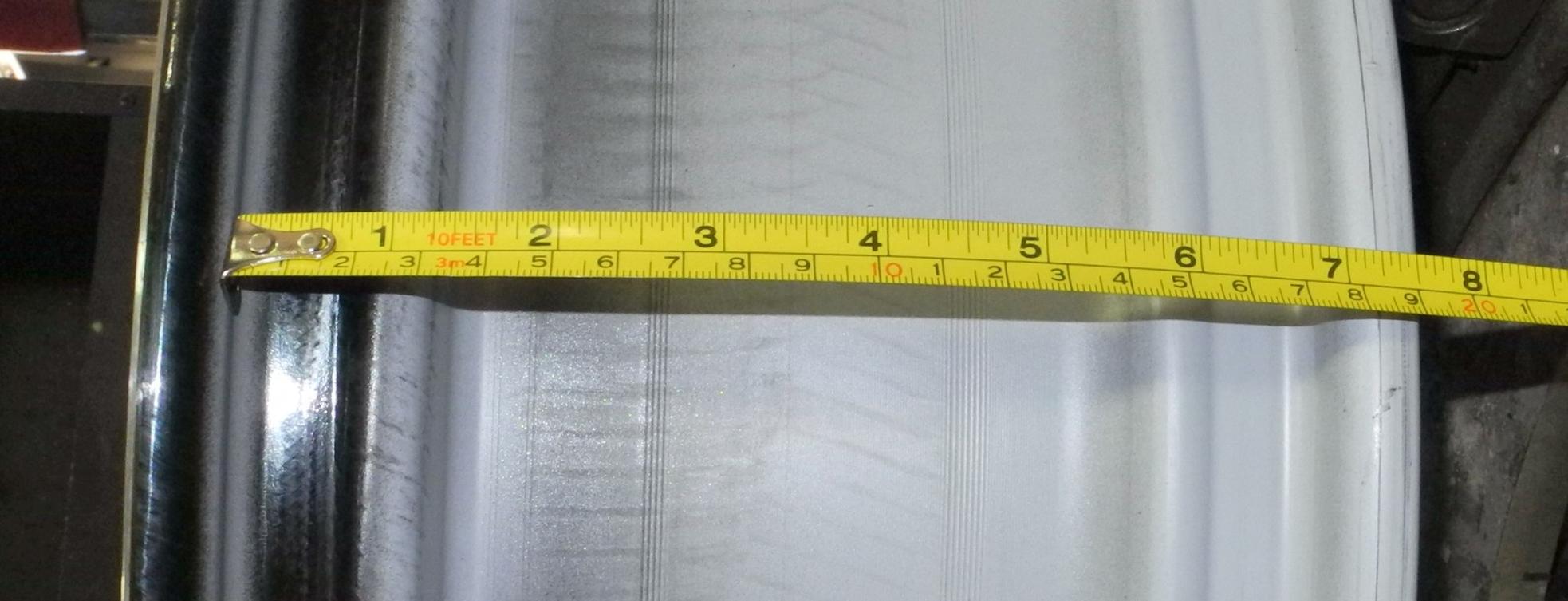

But let me add something about tire choices on the stock 20x7" rim of the LE. "Blonde vs brunette?" Yeah, yeah, here we go again, it's been covered hundreds of times on the forum, but I'll upload some photos to try to contribute something NEW in the way of some VISUAL evidence about the rim size.
I went through the whole "...what tires CAN I stick on this rim?" debate last summer. First, there were many debates about the TRUE dimensions of the LE rim, fueled by an official Toyota PDF somewhere out there which listed the 2014 LE rim dimension as "20 x 7.5 inches". That is NOT ACCURATE!!
My reply: SEE ATTACHED PHOTOS. My 2014 LE rims, measuring 7.0 inches.
As far as whether to mount 275/55 R20s on a 7" rim, the Continental Cross Contact LE20 with Eco-plus tech tires in 111 load rating WERE approved for 7.0 inch wheels (both on the Continental Tires website and echoed on Tire Rack; the higher load rated tires -- 117S -- had a minimum rim width of 7.5 inches; BUT now their lawyers must have sent out TPS reports or something because the parrots at Tire Rack have CHANGED the minimum rim width for the 111 load rated tires to 7.5 while not even listing the 117S tires anymore -- don't you love consistency; I'm convinced the reviews at Tire Rack are at least 50% written by professional shills and this further erodes my faith in their legitimacy, BUT I DIGRESS...). Go to tire rack, enter your tire choice, plug in "275/55 20" or whatever you want, and hit "specs". Look at the minimum approved rim width.
Then choose for yourself. Lots of people mount tires approved for 7.5 + inch rims on the 7.0 inch LE rims. You can decide. But MY driving situation is radical enough for me not to have wanted to screw around with "off label" use. It's not just about lawyers, it's not just about safety. It's about me getting the best possible performance out of my tires that I can.
Best wishes, Deep Snow Commuter

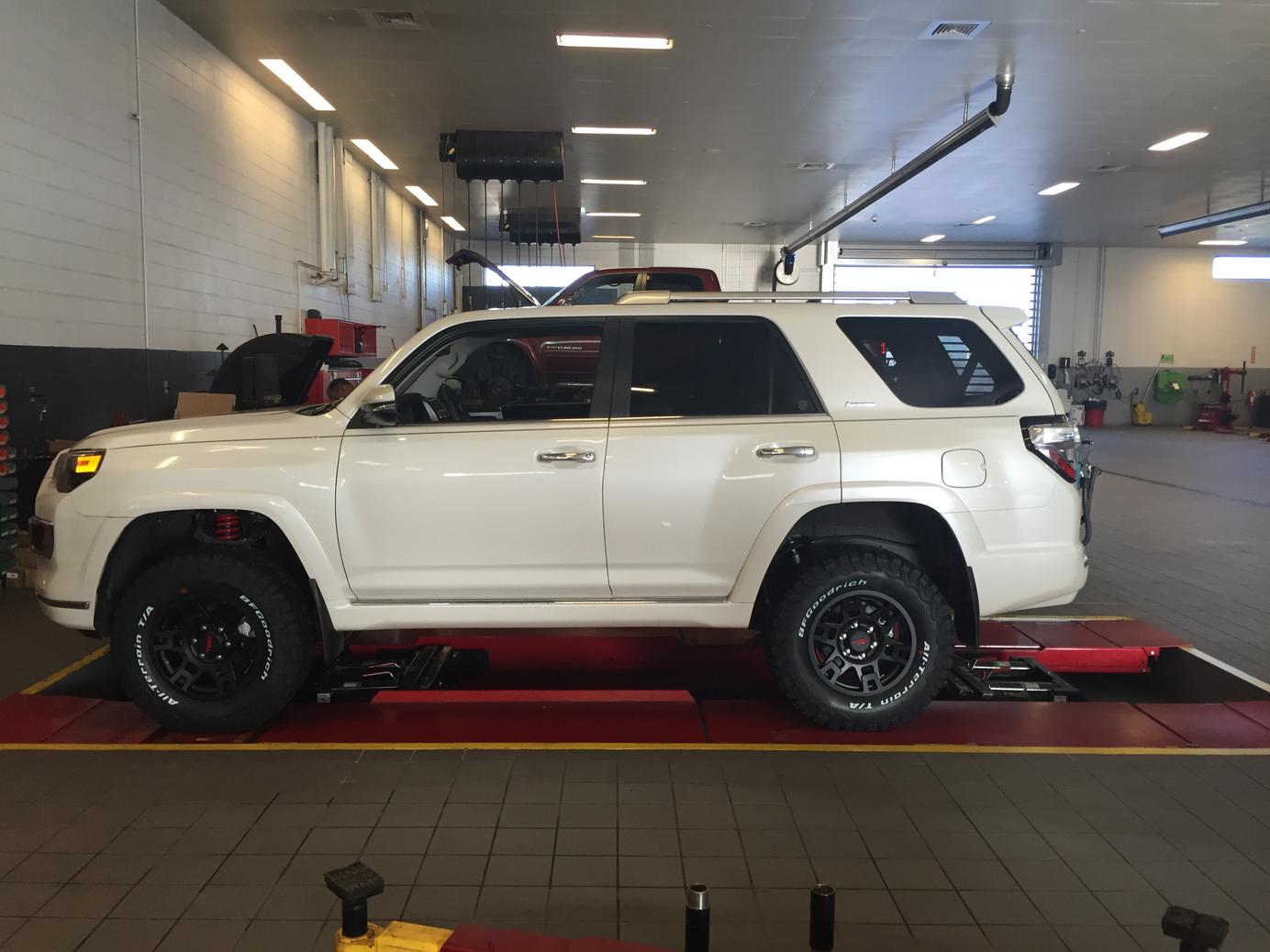

I have a 2012 Limited 4Runner and I swapped out the 20” limited stock rims for 17” rims that are stock on the SR5. The off-roading that I do is on the beach surf fishing so a tire with more rubber that I can air down to get a wider profile is better suited for my needs. I am intrigued by Rigtec’s comments implying that I might not be getting the most out of my limited 4Runner running on 17” rims and 265/70/r17 tires. I had Dunlop brand tires that are pictured but last week I just switched to Michelin LTX MS2 tires. I have been happy with the ride and handling of the vehicle with these rims and tire size. My perception is that I am seeing a trend with more vehicles outfitted with more wheel and less tire which appeals to some people from an aesthetics standpoint but might be giving up something in terms of comfort and functionality. I think that the limited 4Runner looks fine with 17” rims, I’ve been thinking about at some point upgrading to a different rim but I like how the metallic look of the rims matches the metallic appearance on the door handles. I’ll let you guys be the judge.
Went with black 17"'s and never looked back:nod:
More sidewall, more tire options, and better look in my opinion.
Sold my 20"'s on craigslist within a week of posting.
