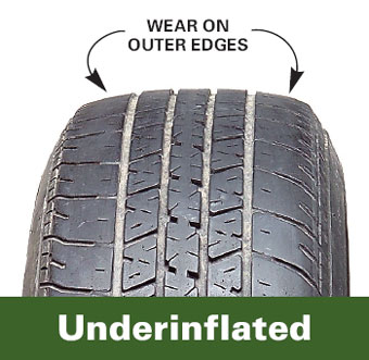

tire pressure is fine.
Has it always been fine?
Look like this?
