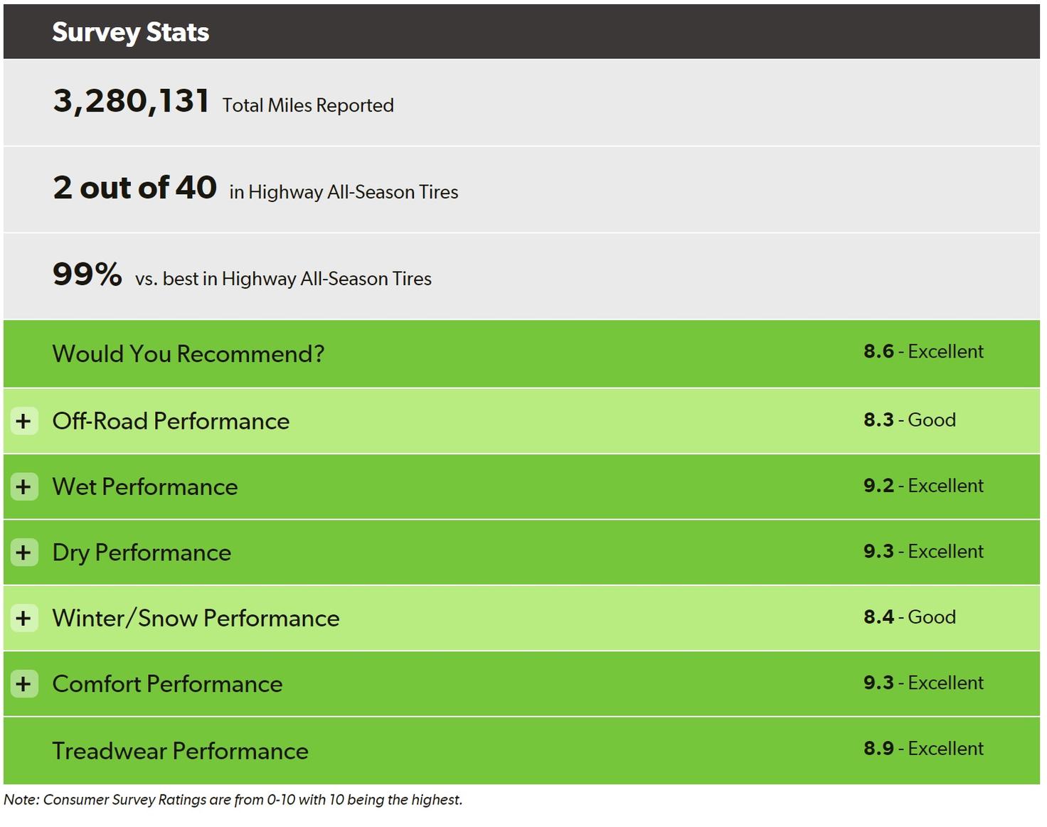

Tire Weight Concern
Michelin Defender LTX P-rated
265/70/17 = 39lbs
255/75/17 = 38lbs
