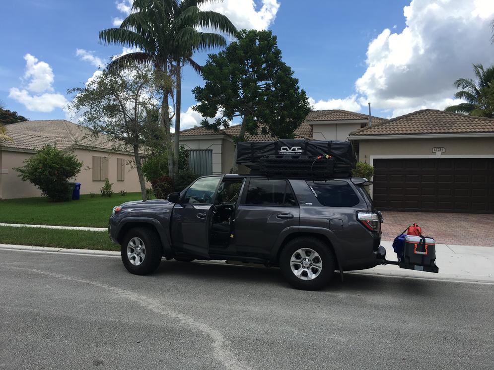

I did all of the same research for 2 years and ended up with the 275 70r 17 AT3 c load. After 6k miles 95% on road and 5% off I couldn't be happier.
Wet traction: Excellent
Road noise: minimal for an AT tire
Off Road: nothing they haven't handled well (sand, mud, rock)
Here is a pic with the black sidewall out on my Irma evacuation vehicle.

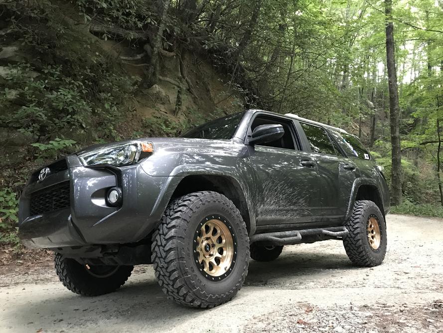

i run E rated Toyo M/T's and i get around 16.7 combined mpg. i don't do a ton of highway driving maybe 300 miles a week on highway and 100-200 miles in city. As for offroad use i can't tell you anything but good they are tough heavy aggressive tires but after i spent 3 hours riding some atv trails they road like streets tires doing 80 down the interstate. i plan on outfitting my rig with RTT custom drawers etc and taking a very long road trip to Alaska this fall or at the end of winter

1) No off roading with cargo hitch loaded. Just bought it last week at Walmart for some extra storage to get out of town for the storm. I would not recommend for off roading at all due to the torsional flex and extreme reduction of departure angles (I almost scrape coming out of steep driveways). It would be fine on dirt/gravel roads and light off road beach driving.
I haven't been off-road in sharp rock desert southwest/Moab conditions, but the AT3's have been more than fine on the limestone/quarry rock and sharp coral we find here in Florida.
2) I jumped to 275 because it was the largest I could put on with stock suspension. I figured if I do a mild suspension upgrade in the future it would give a slightly better look. That leads to the second reason, honestly I thought they would look better and they were only about 2lbs heavier than the 265 c load version and actually lighter than the 265 E load and 275 KO2 e-load. I lost about 1 mpg overall vs. the stock dunlops. FWIW the LT AT3's have 17/32 tread depth vs. 14/32 on the KO2's and they seem to clear very well in mud, which we have a lot of in Florida unfortunately.
