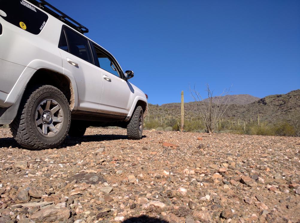

If you put on 200 miles a weekend in the dirt I would go with the E rated tire just for extra insurance. There is more rocks where I live in Arizona from looking at your pictures. 275/70/17 KO2 tires aired down to 20-24 psi will work great in your area. If it were me I would get 5 tires so I had a flat in the middle of no where I would have a good spare I could rely on to get me home.

Vote for Cooper S/T Maxx's...love running them in 255/80/17 Skinnies! Awesome for the desert SW
