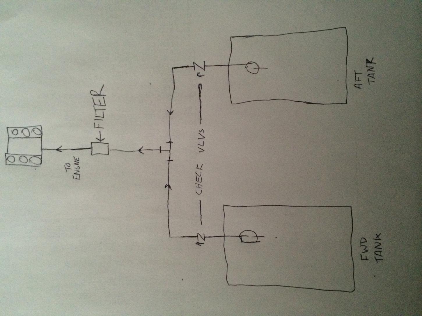

I was thinking about getting a set up that has two pumps, tow tanks and two check valves. Have it set up to a switch that will select which fuel sending unit is sending the signal to the gauge and viola, duel tank set up, have a seperate filler that I would somehow fabricate into my cbi bumper kinda like the old 67 impala. It's easier said than done...but duel tanks guys. Duel tanks!
Again this is a very simple flow diagram, the way you
Could set this up is endless if you know mechanical engineering. You would put a 20 micron filter element before the check valves or whenever, now I'm not too keen on electronics or drawing wiriing diagrams so that's going to be left for someone else to do.
