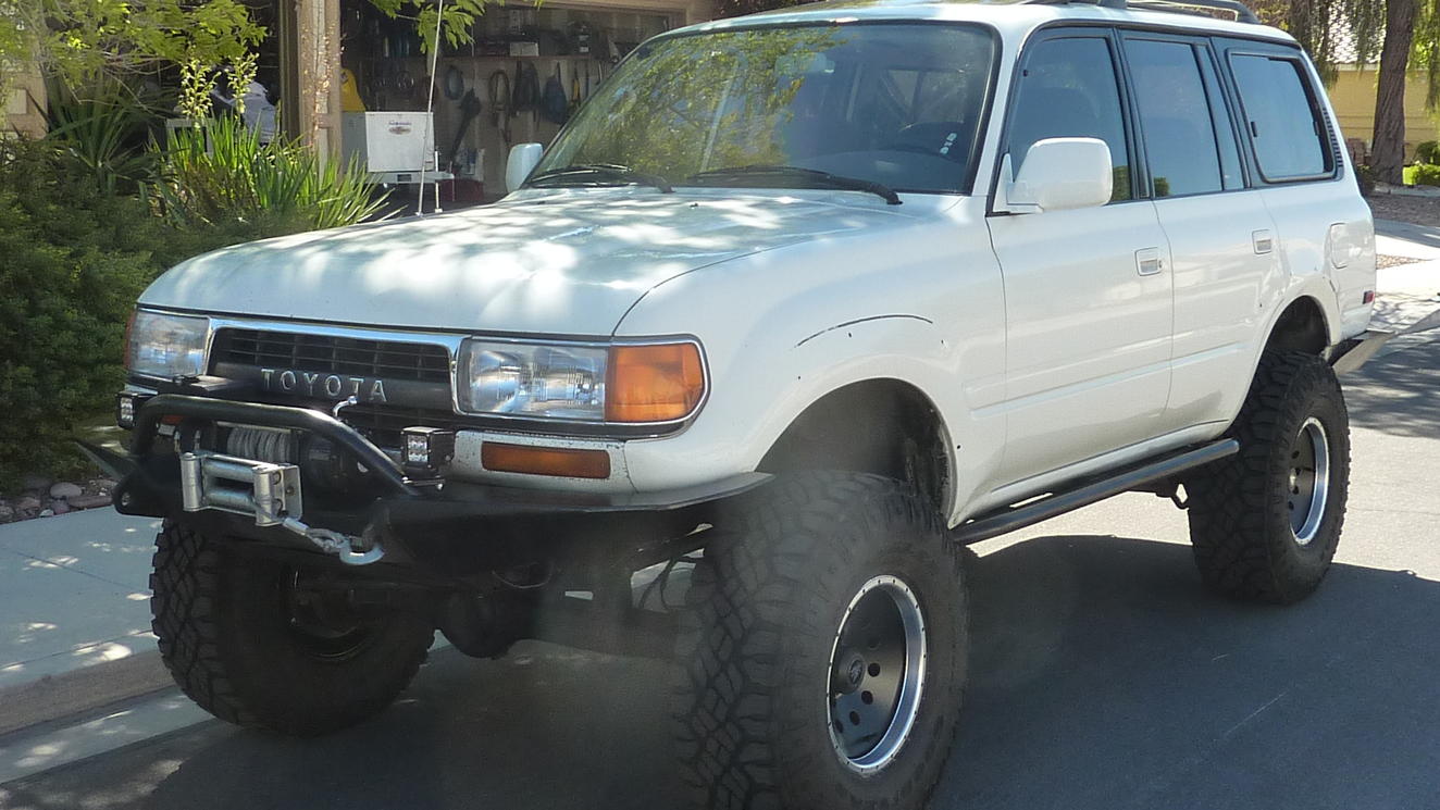

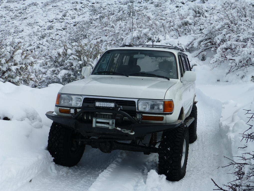

I had a 1994 LC, on 35's, 5.29's,linked front end, plate bumper, etc., and it pulled no better than 13mpg, usually more like 11. I had to fill it up every other day. At least with this runner I can get 300+ miles out of a tank, instead of the 200 I'd get to 1/4 tank with the FZJ80.
The LC was pretty awesome for a 5600lb vehicle, but it didn't make sense to me as far as an expo vehicle. There are guys on mud and the expo that have added the ROW aux tank, but it's an ordeal and it's not cheap. The way these rigs work best is with a turbo diesel, but you better not be in a hurry to get somewhere. :sleepy:
