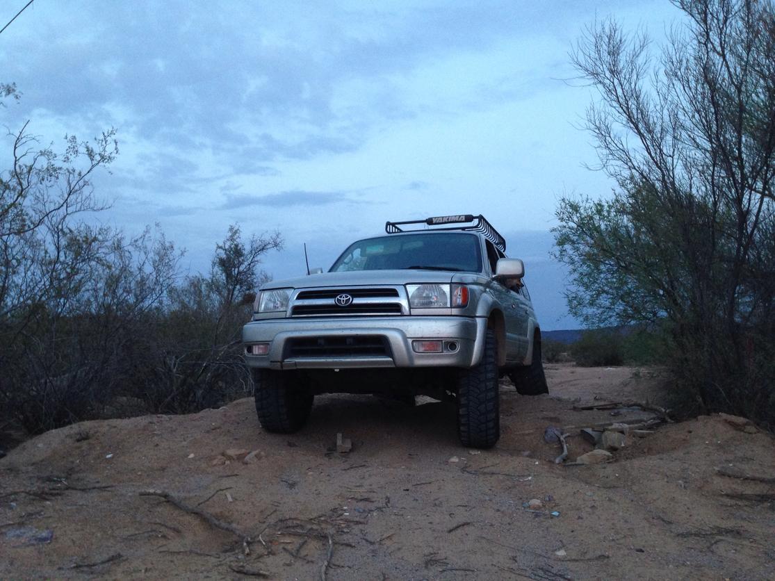

Stock bumper. stock front springs over tundra 5100 on 5th setting
Front bumper and winch weighed the springs down alot. Also exemplified the fact that these springs werent designed for that much weight up front.
Only side shot I have with the stock springs front with some weight. Notice the front flares are off, had to take them off during wheeling because the stock springs made it flex and rub alot.

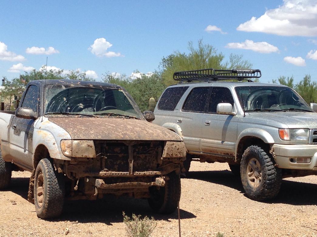

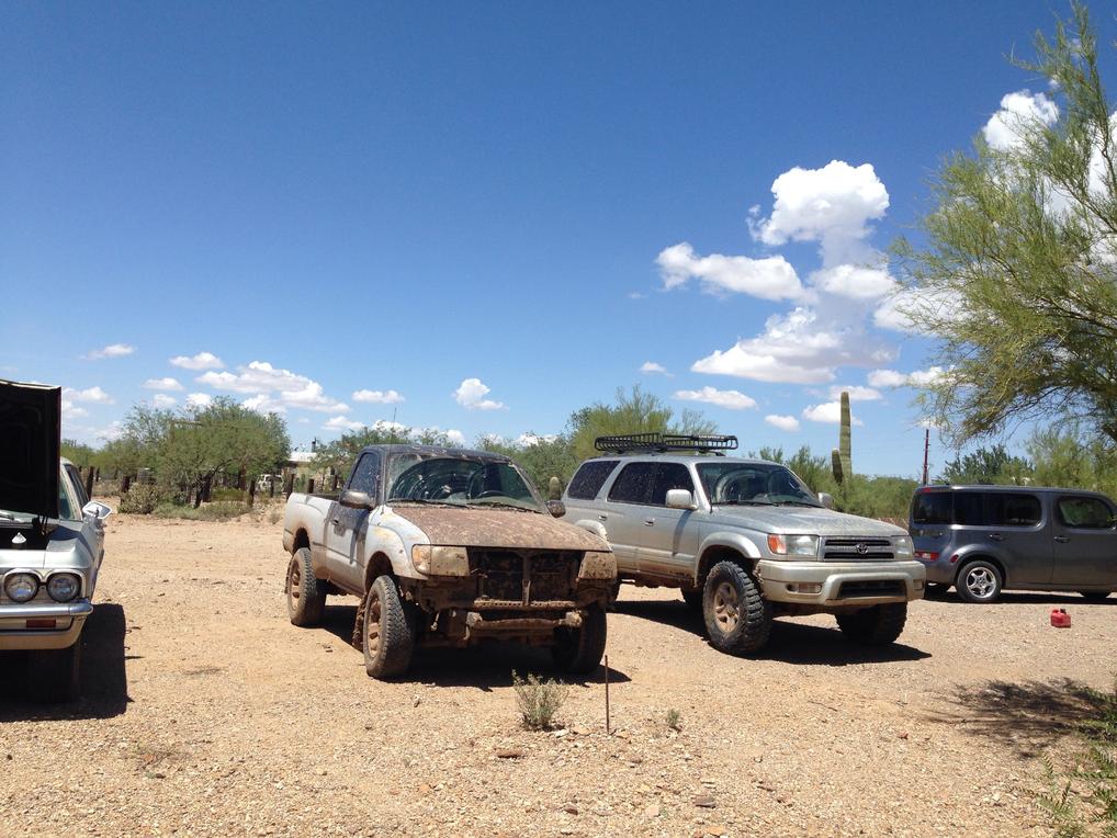

Mine currently has a 1" spacer in the front and stock rears it's not the best picture but you can get a idea of mine
