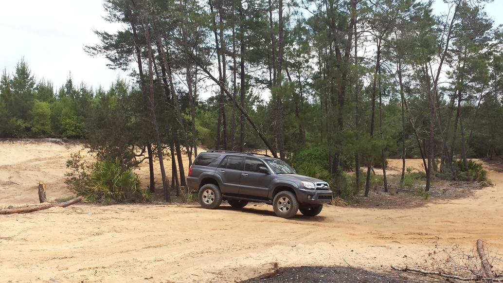

It will help with 33" tires on full compression some (I have some rubbing under full compression and flex with my 33") but other than that, there's no real need for a Body Lift besides creating more clearance for larger tires.
Plus, it just makes your rig look awesome IMO :lookout:
