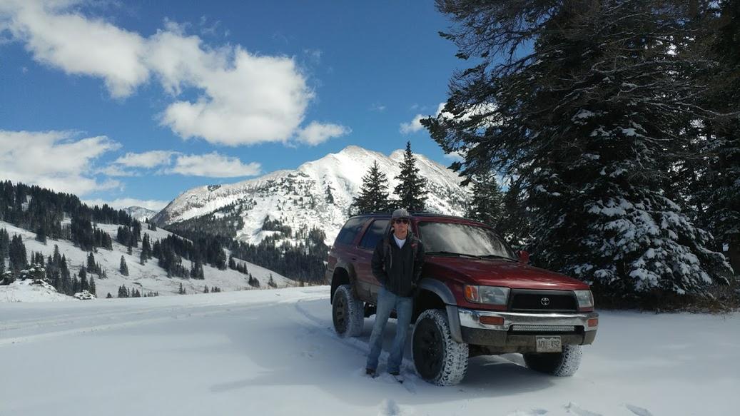

As Tobiko sits today!

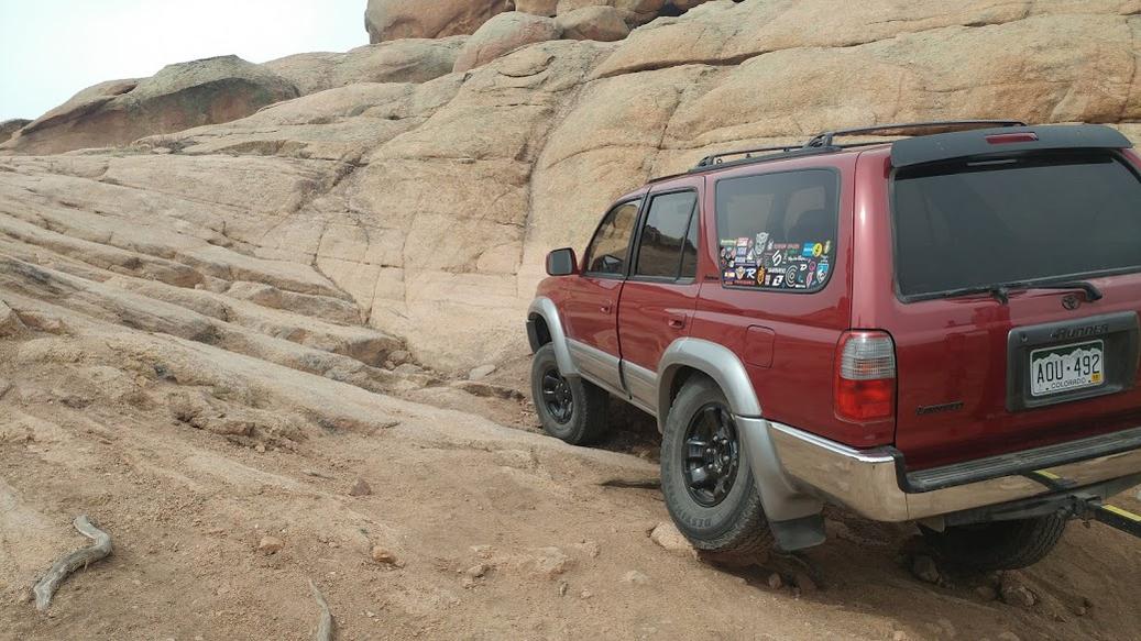

Found some gnar today while mountain biking up at Hartman's Rocks in Gunnison. Thought I'd stretch the legs since I haven't be able to do so all winter!
This is why I haven't bothered upgrading to larger tires yet because I can get ultra flex with these 265's!

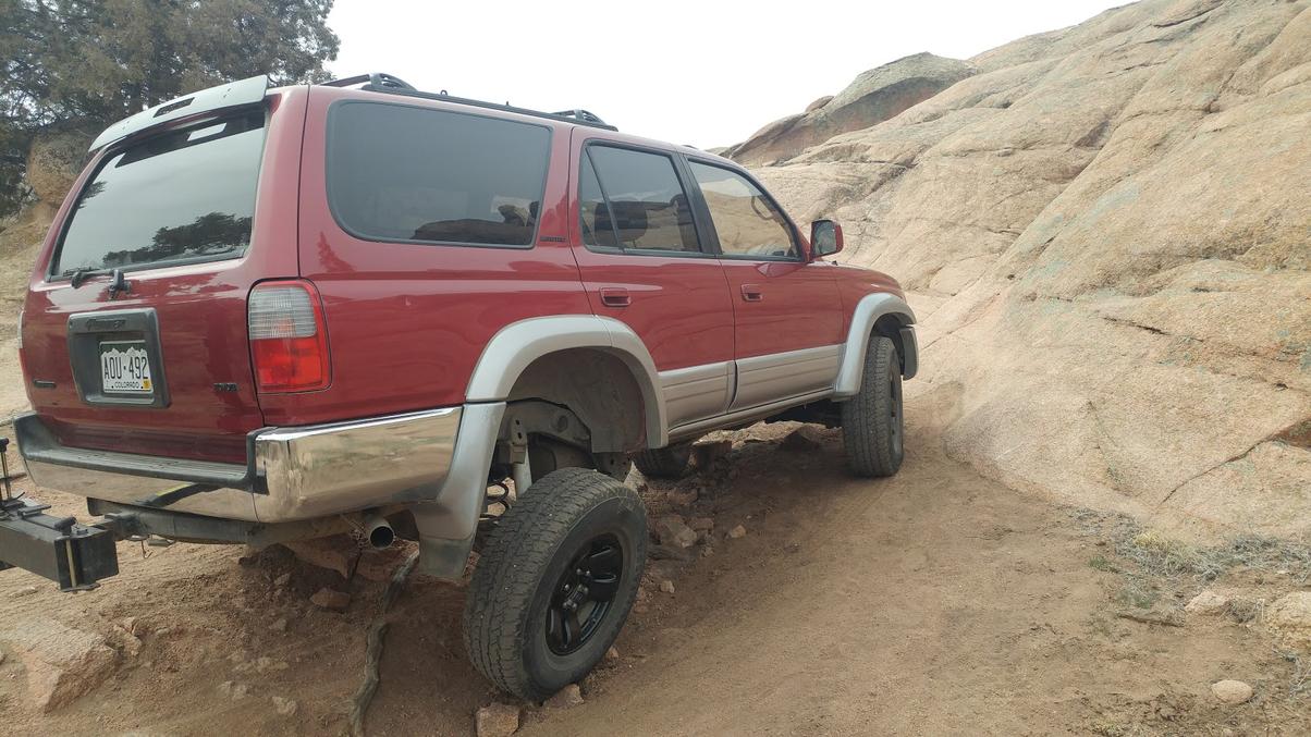

Also for those interested in my Frankenstein type lift, I've managed to not use any 4runner-specific coils or shocks and the reason for that mainly came down to cost, and availability.
My rear setup consists of the 8.75 wrap coils off of the older LX450 models, matched up with some cheap Gabriel shocks (G63615) I found on RockAuto for like 60 bucks all together for a 1995 FJ80. The rear shocks measure 13.88" Collapsed length & 23.66" Extended length. This length compliments the LX450 coils nicely and I am able to achieve max articulation WITHOUT aftermarket bumpstops. Yes, you heard that right, I am still running stock bumpstops! My tires lockout against the wheel well just slightly before max stroke of the shock, so I don't have to worry about them snapping. That is a benefit of having this setup.
Hub to Fender Measurements
Front:
DS -- 23.5"
PS -- 23.5"
Rear:
DS -- 24.25"
PS -- 25"
