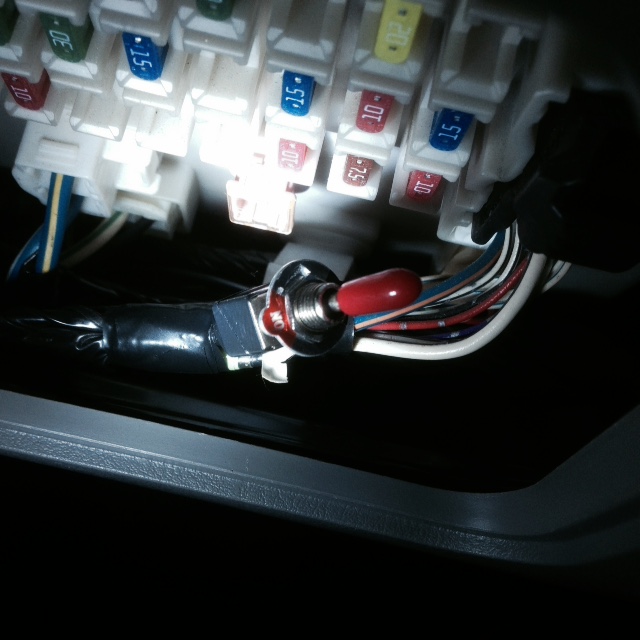

46runner Member Dec 6, 2014 #1 I went exploring inside my fuse panel today. And found this toggle switch. It is in the off position. Anyone know what this is for? Attachments 4runner-toggle.JPG 103.2 KB · Views: 527
96 ToyRunner Member Dec 6, 2014 #2 Im just taking a shot at it but it looks like its a hidden kill switch to keep from some one driving off in it.
riceandpho Elite Member Dec 7, 2014 #3 theres an aftermarket alarm on the truck, its the valet switch. either the brain is mounted on the kickpanel or under the steering.
G gshadow325 New member Dec 7, 2014 #5 99.9% its for a dei remote starter. its a override to turn off the remote start option
