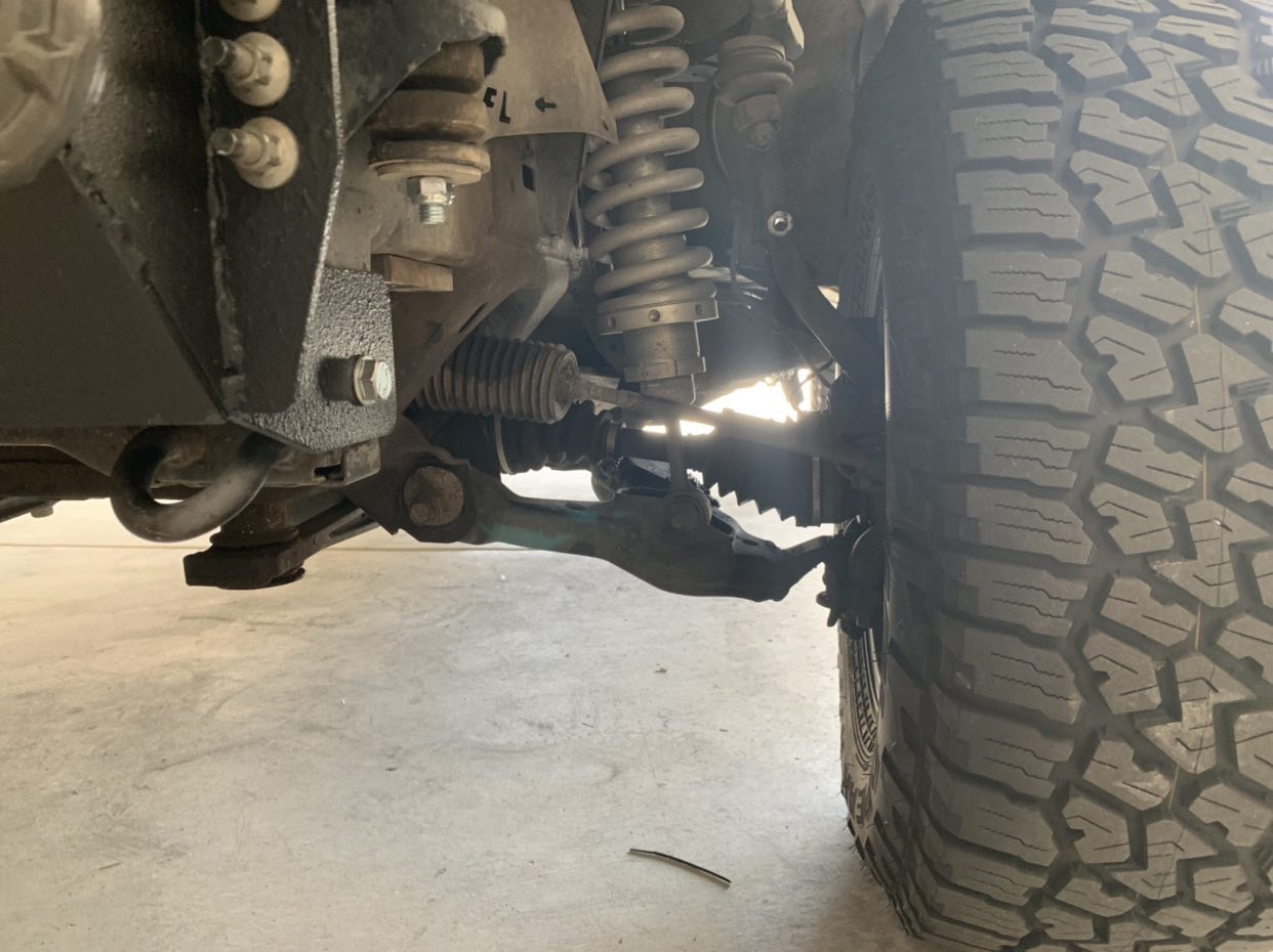

Took off passenger side tophat spacer and a lot of the binding has gone away. Tacked up the coastal off-road front bumper but the boots still touch.
Before
After
How's the ride... The whole suspension looks stressed as hell like something is gonna pop.
Looks like you are gonna need to recheck if everything was installed properly (coil position or what not), either that or you got the wrong parts.
Super bouncy with even just the plate bumper up front.
I am new to installing lifts but not new to wrenching. I can guarantee that everything is 100% the way it is supposed to be put together. I had a shop install the spring onto the driver side strut, and i did the no spring compressor method on the passenger front. Both sides are on the lowest clip setting. All bolts torqued to spec.
