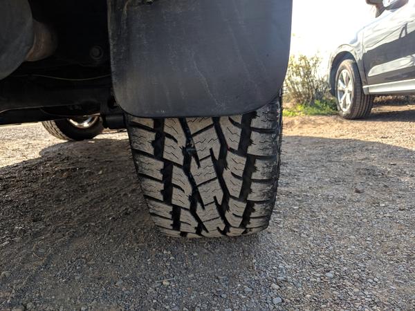

I got that in a Toyo open country a/t 2(E rated). And I can't decide if it's a bad size and rim combo, or if they are just the wrong tire.

I have E rated tires, and wondering if that's why I don't get full contact. And the tires are annoyingly squishy, get very weird sensations all the time.

It's possible. I used the chalk method and the highest I can go up front and have a full contact patch is 36-38psi.

Sounds dead on to my setup. This is mine after roughly 1/2 mile dirt road and gravel parking lot.
The fronts looked better, but I think that was due to the turns.
seanwn86-albums-tires-picture53312-toyo-2-e-rated-275-65-18-%4035psi-cold-after-roughly-1-2-mile-dirt-gravel-road-parking-lot.jpg
Yeah, after that long on a dirt road I'd expect to see more dust/dirt on the shoulders of the tire. That looks like it doesn't quite have a full contact patch. What pressure are you running on the front and rear?
