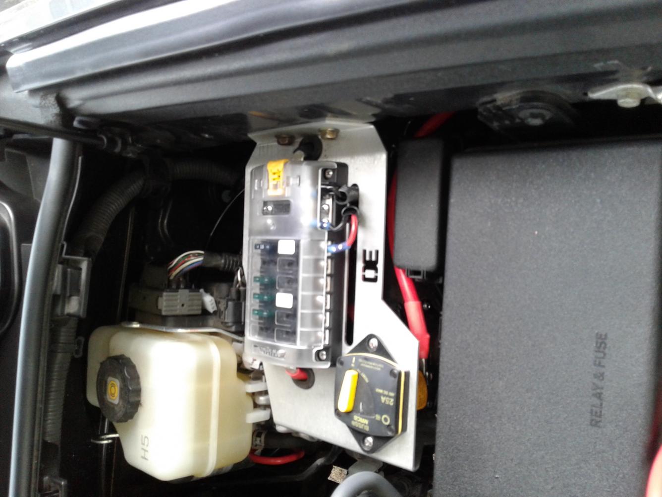

here's my set up
i dont have much on it yet, just the light bar harness.

You probably have this covered, but you may want to revisit your anytime back/front camera setup to see if the front camera is powered on constantly. If so, maybe you can delete one battery connection. Some generic camera installation instructions direct you to connect to the battery or ignition-on +12V. You really only want the camera powered on when you select it via the Front-Off-Back switch; that’s where you should connect to get the camera power.
