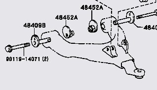

They are indeed part of the alignment system, and they actually work on all three dimensions. They primarily effect the camber when the front and rear are adjusted equally, but can impact the toe when adjusted individually.
As you can see in this pic, they have an off-center bolt attached to the plate, so they act like a cam when the plate is rotated and make the lower control arm move inboard or outboard as needed.
