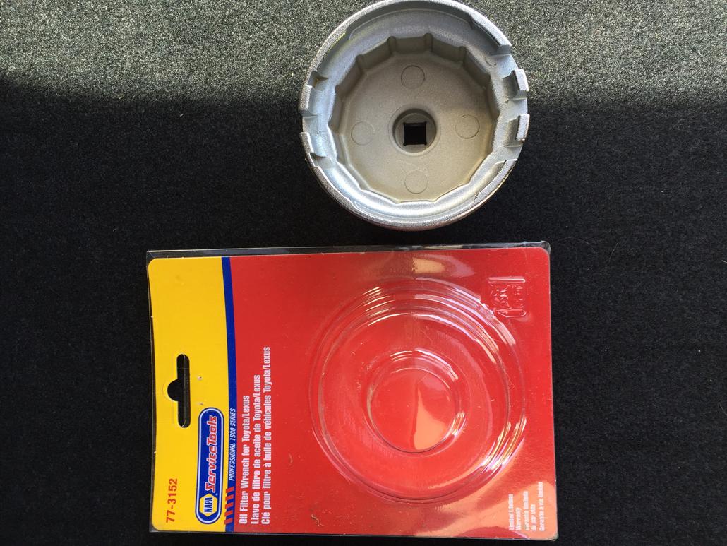

Oil filter canister wrench. I have a cheap one of these but there are better built ones out there. This one is a Napa offering someone posted a few years ago, looks pretty good and is similar to one that Toyota sells. Uses a 3/8" drive. I don't trust the 10k mile oil change intervals so on long trips I change my own oil. Oh and make sure your skid plate bolts aren't stripped. Dealers oil change monkeys are notorious for stripping these out. Not something you want to deal with doing repairs on a long trip.
