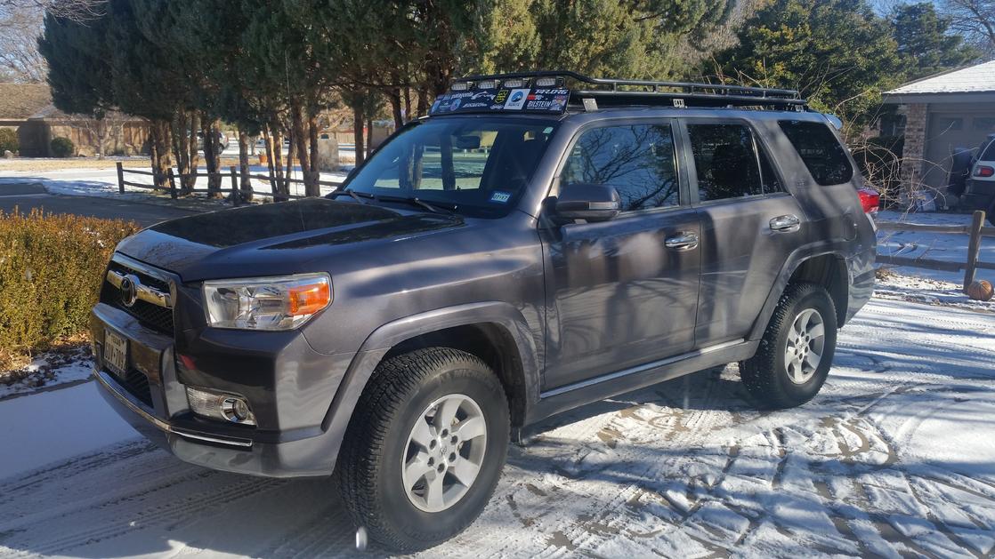

So are you telling me the wind sock on my roof top is not aerodynamic. And yes, bigger tires in the future too. :crazy:

Yes what he said !!! We're driving a very nice motorized box so if worried about mpg move on to something else :wave: ! I know most won't want to hear this but Crawford eco block works pretty good on the road not around town driving ! Seems to help on mine where your chance for a consistent speed works well & I normally drive 80ish on cruise been lucky to get 330-340 on a tank & that's before light blinks 285s also :eyebrows::flame:
