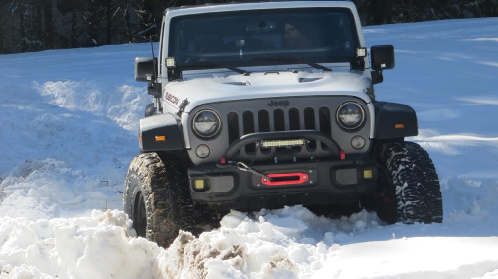

I never would have recommended a Jeep until I make a snow run with a group of built JKs. They were impressive.

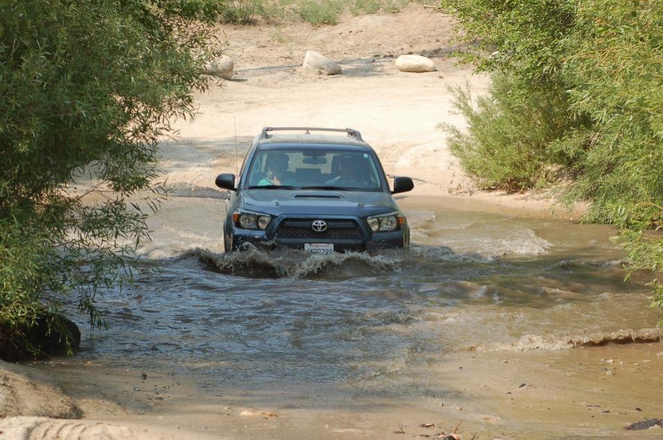

Check the SoCal section on this forum. I came from SoCal and had some very good group trips, help and information from members of that group.
Photo on 2N16 near Green Valley Lake.
