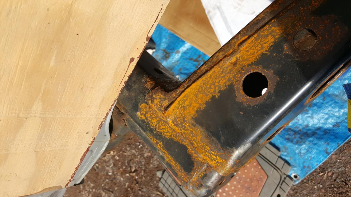

With the MN weather finally nice enough to work on vehicles outside, I went ahead and removed the hitch. There was lots of flame and penetrating oil and at least one of every problem that I've read about others having: another broken bolt head, the internal nut breaking loose, etc...
So here's where things stand:

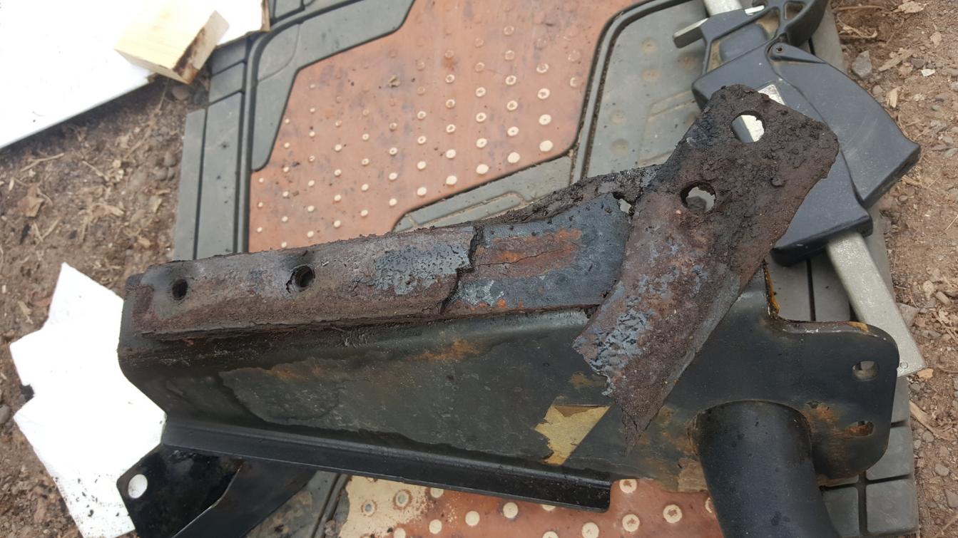

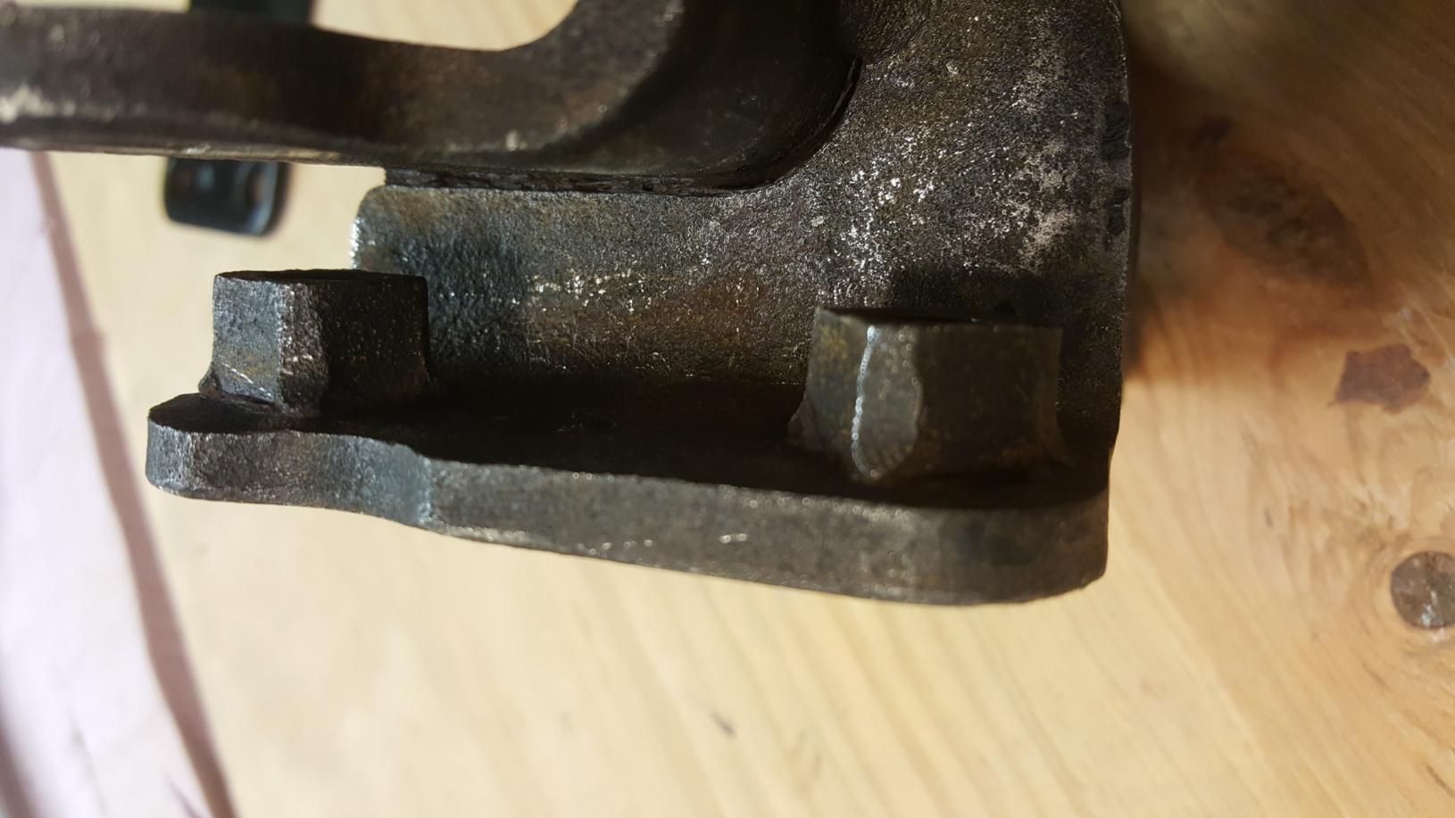

The hitch is totally removed. I went ahead and cut the bolt whose nut had broken loose inside the frame. In addition to the two bolt heads that I snapped, there was another, but at least they all have some threads poking out. Lots of heat and oil should hopefully coax them out.

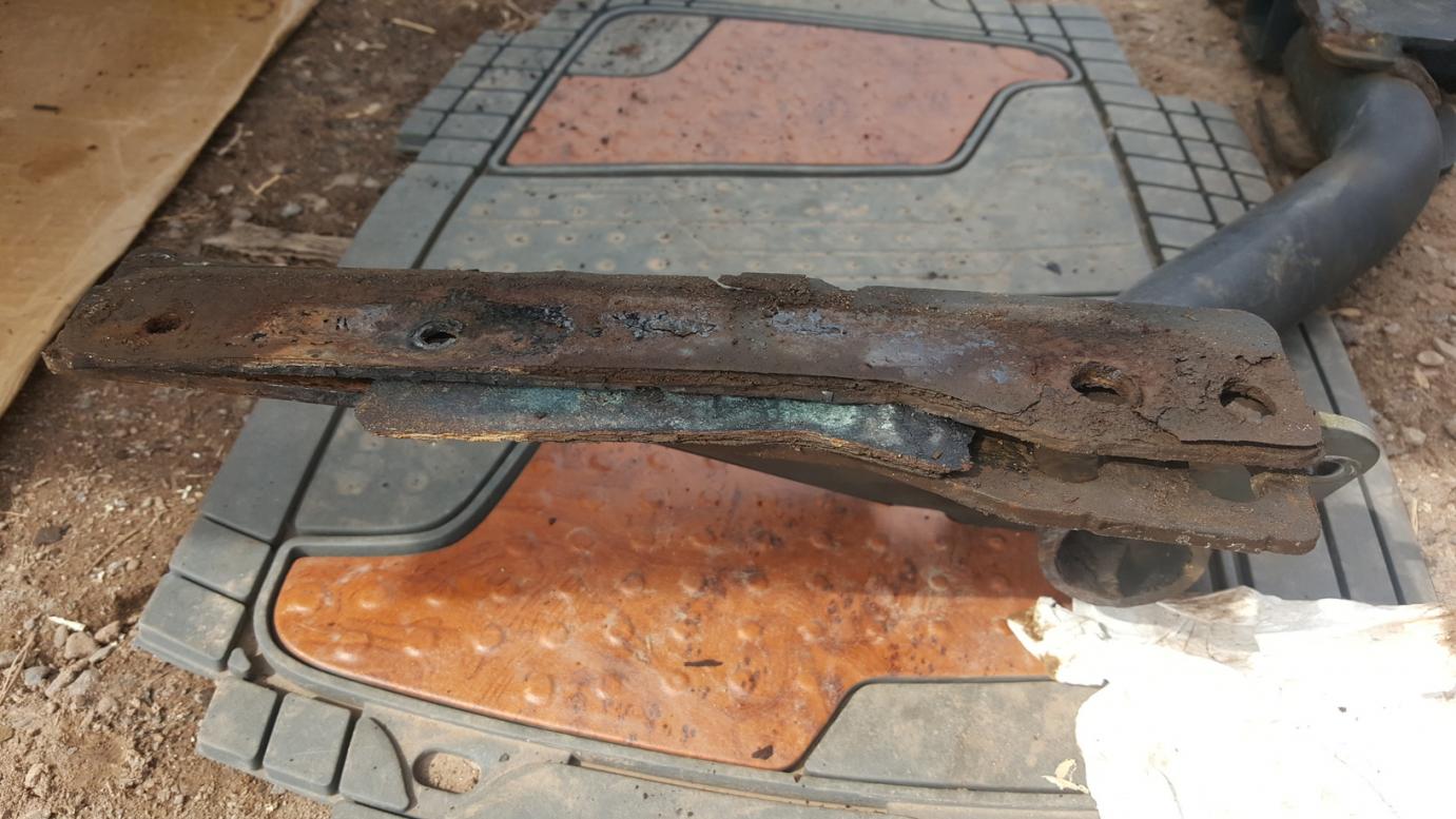

There are some plates/shims that were sandwiched between the wings of the hitch and the frame. They are totally destroyed. There are also two plates on the cross-memeber section that are still in good shape.
My two main questions at this point are about the two plates/shims between the hitch wings and frame. As you can see from the pics, they are totally destroyed. Is this a dealership thing or could I find them aftermarket? I don't even know what they're technically called. Second big question is about all the bolts. I will be replacing most all of them but don't know where exactly to find the specs.

You can find a local fabricator to make you those plates that have been destroyed by corrosion and as for the hardware you can take the old bots to any hardware store to find the thread pitch.
I doubt those plates are an OEM stocked part. These rigs are pushing at least 11 years old and were first introduced 18 years ago.
Thanks for your input royal. While I'm sure I can get the plates made locally, I'm afraid they are too destroyed to get any specs from. I'm not sure how thick they are supposed to be and exactly what their shape is. Unfourtanely they are not a simple rectangle. I'm also not even sure what purpose they are supposed to serve. Has anyone else delt with these corroded plates? What's their deal?
I do have at least one of each different bolt, except for one. The hitch wings have 4 bolts on each side, 2 larger ones near the rear and two smaller ones towards the front. Referring to the larger bolts, the driver's side was missing one and the other one snapped off, and the passenger side was missing one and the other one had the nut break free inside the tube frame. This is where I could really use some specs.

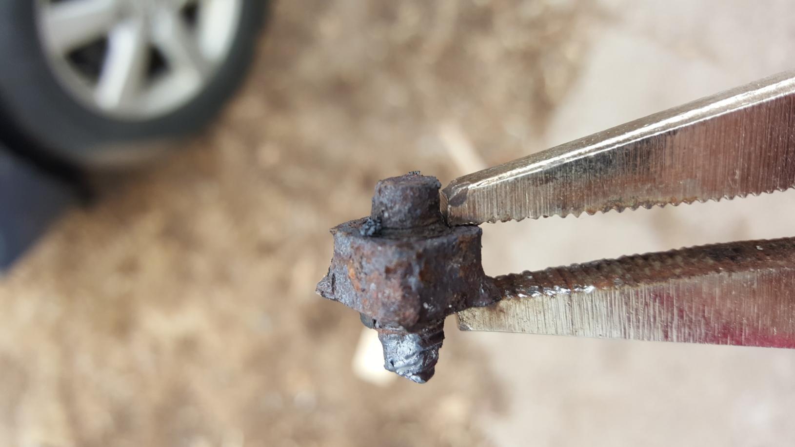

Since I will have to drive it some during the week, I tried to tie up the loose ends for now. I gave the broken bolts another try with vice grips but they weren't budging. At that point I decided my best option would be to just pound them back into the frame busting off the internal nut in the process. I'll have to cut a little hole in the end of the frame to get access inside with new nuts and washers.
I'm still really dying to know about these damn spacer plates. I've read all the thread here about the towing hitch and I've not seen any mention of these parts.

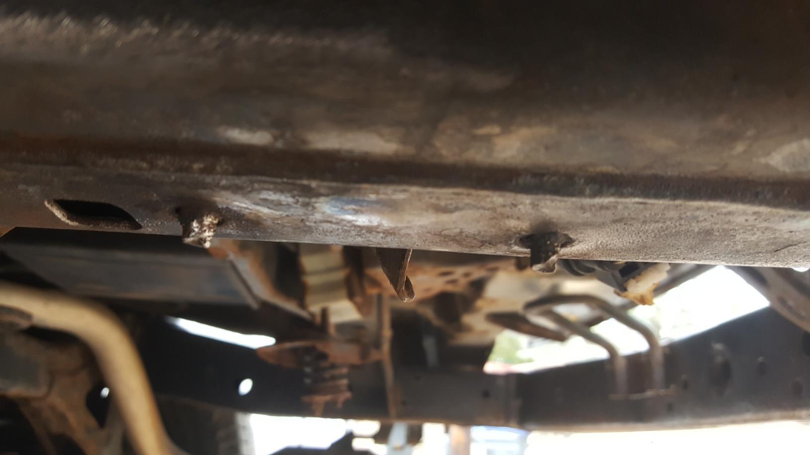

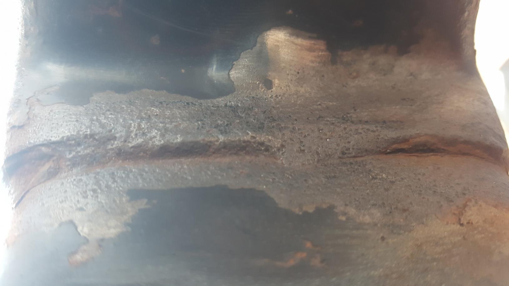

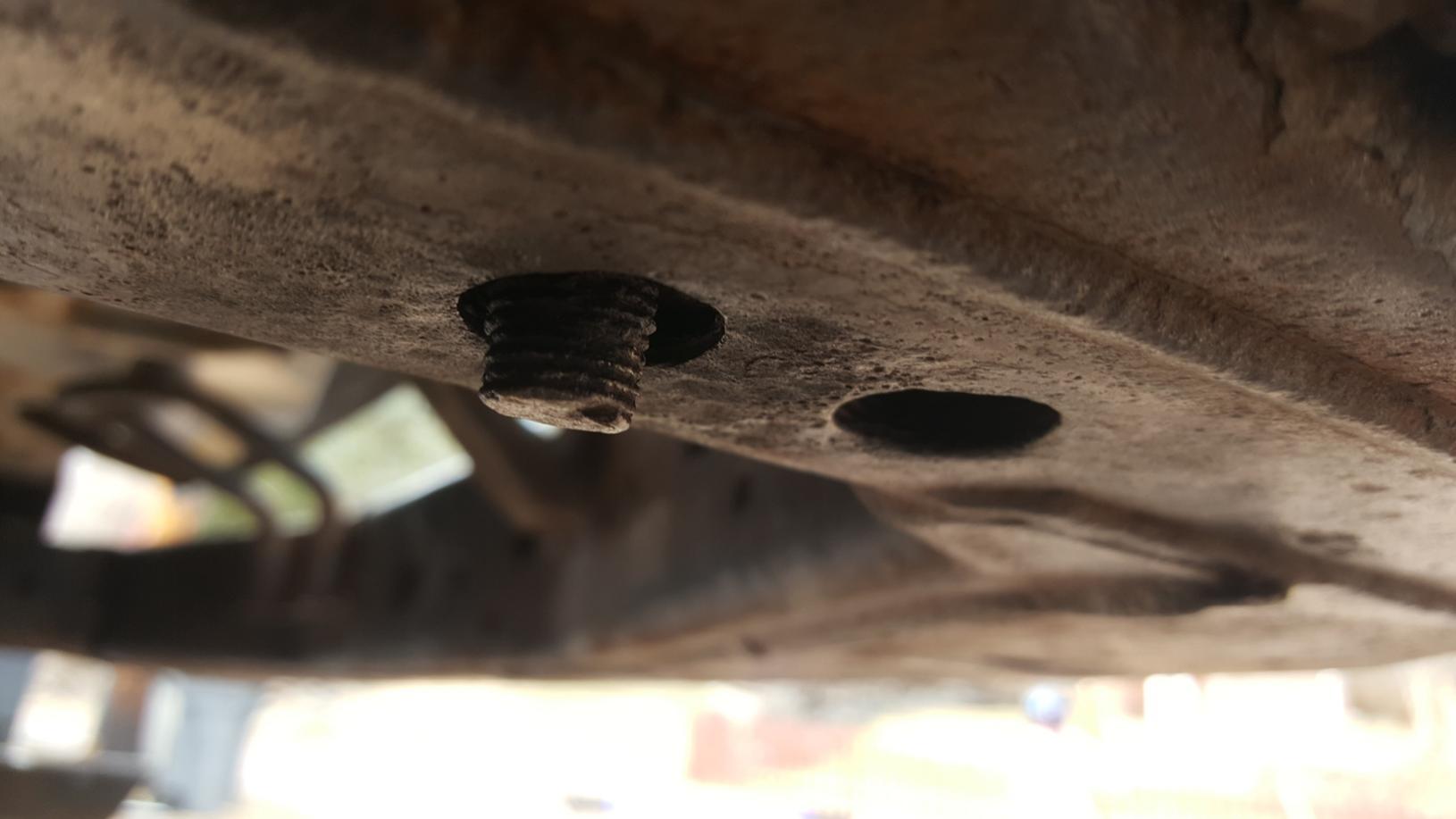

The pictures show how rusted the last two bolts were that I pounded out. It's safe to say that those bolts were never coming loose. The other pics are of some of the rust pitting left on the cross-member after I cleaned it up wit the wire wheel.

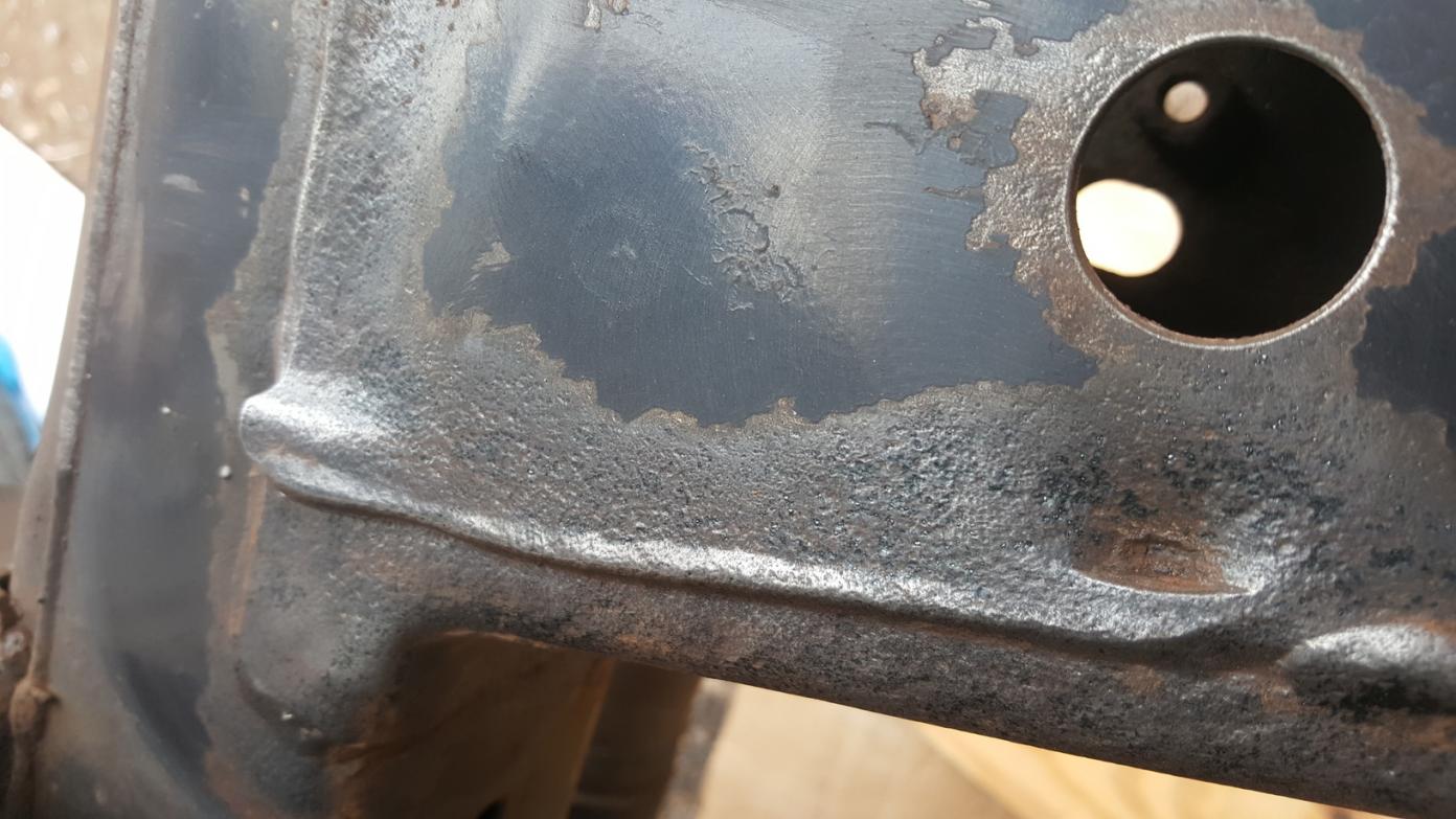

Here's a pic of the rust that showed up overnight due to some rain. It came right off though.

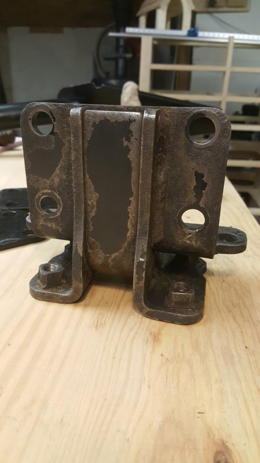

It was a productive day. It's amazing what I can get done when the kids aren't home. The hitch and cross-member both got two coats of paint. The cross piece is done since it'll never see the light of day again. I think the hitch will get a scuff and one last coat.

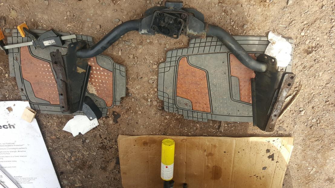

The so-called "V6 hitch" that bolts to the frame cross-member has some tight spots and isn't conducive to cleaning up with the wire wheel. That means I finally get to try electrolysis to remove rust. I've wanted to try it for a while on some old hand planes but this job came up first. If your not familiar, check it out. All you need is a battery charger, some wire, and a sacrificial piece of steel. Through the miracle of chemistry, the rust is removed from the selected piece.

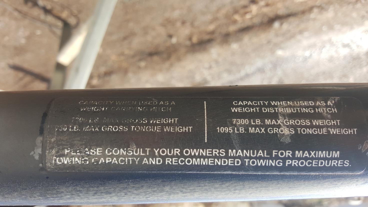

Finally, I wanted to snap a pic of the sticker on the hitch before I painted over it. Although its faded, I can make out the text. Maybe someone here can help determine the difference between "weight carrying hitch" and "weight distribution hitch" as it is labeled here. The numbers for the 'carrying hitch' are what I'd expect with the tongue weight being 10% of the total towing capacity. I'm not sure what the 'weight distribution' info is for. Does using an external weight distribution hitch, with the bars and chains, increase the possible tongue weight by 300lbs? I might have to post this question over on the RV forum I'm on.

As I expected, my question about the two weight ratings for the hitch was quickly and definitively answered over at the RV forum. Here's a link to an exhaustive article if anyone is interested.

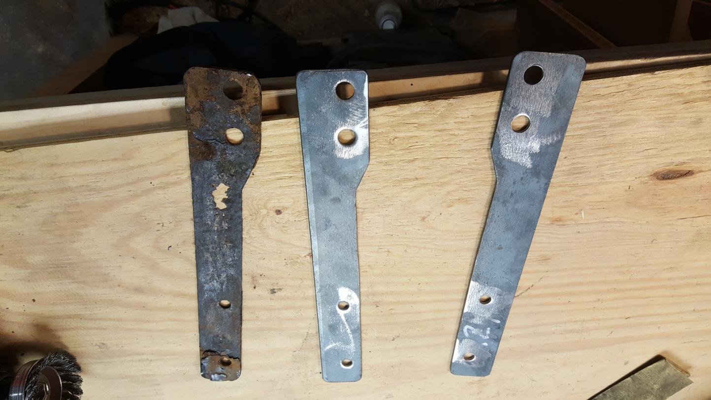

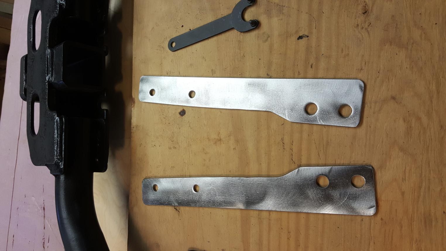

I'm happy to say the spacer plate saga is over.
I waited at the shop while they made them and walked out 30 mins later and $40 poorer. The owner was a nice guy and a top-notch B.S'er so we shot the breeze while I waited. I couldn't be happier. I got them cleaned up and ready for paint, prepped the hitch for a final coat of paint, picked up all the hardware, and even finished up all the painting before I had to pick up the kiddo from school at 2.

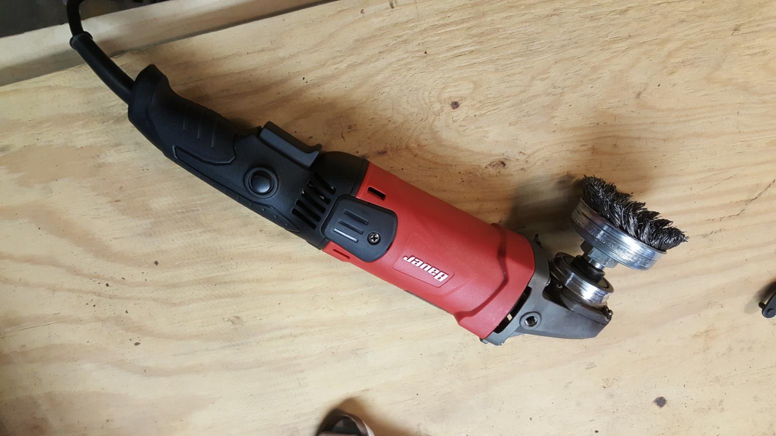

So I've gone way too many years without an angle grinder and finally picked one up earlier this year for a project on my camper. Since I've made it like 15 years as a bonafide DIY'er adult and got by without it, I figured I'd go for something cheap. I got the mid-level one from Harbor Freight and it's been a champ! It cost about $40 and it did everything I asked of it. Simple to change bits, no vibration and it wasn't even too loud.

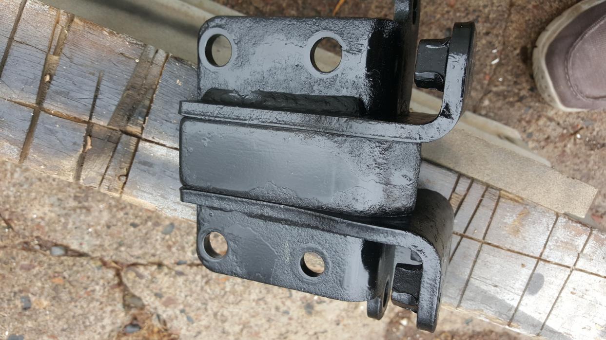

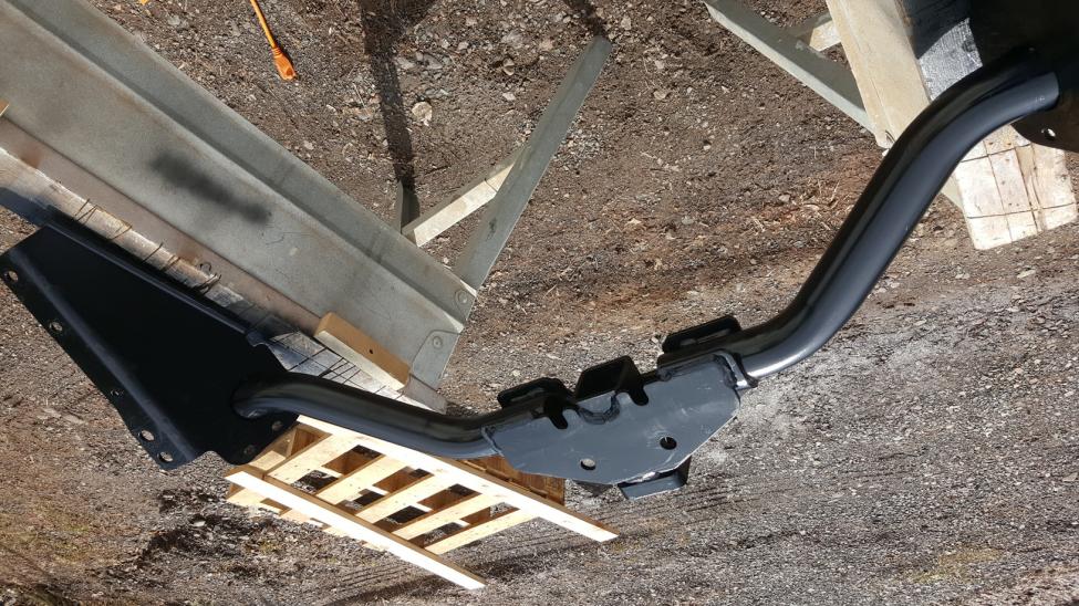

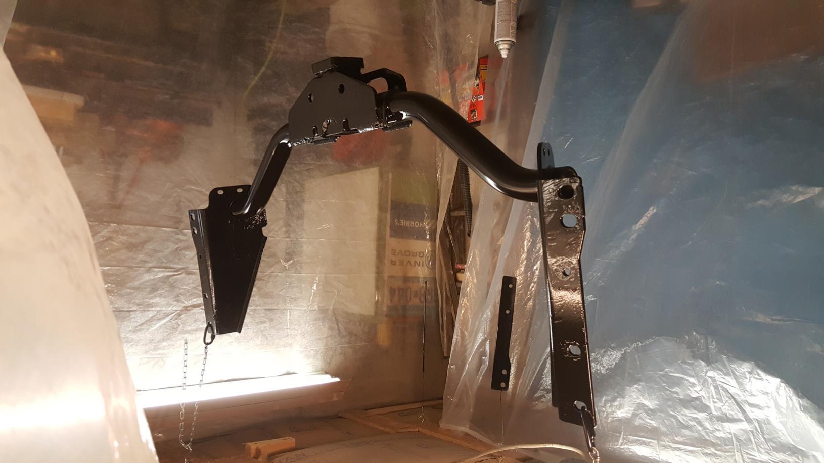

It's been rainy and gross here for 3 solid days so I haven't been able to put everything back together. I thought I post a few pictures of the cleaned up, "V6 hitch" attachment. I'm bummed that I forget to get a 'before' picture but the rust was pretty bad. You can see the substantial pitting left after all the rust was removed. I can hardly believe how well this process works! It was in the solution, hooked to the charger at 2 amps, for about 5 hrs. If I would have chipped off most of the rust flakes and given it a precleaning, it probably would have only taken an hour or two. Here are some pics. Hopefully they're not upside down.
