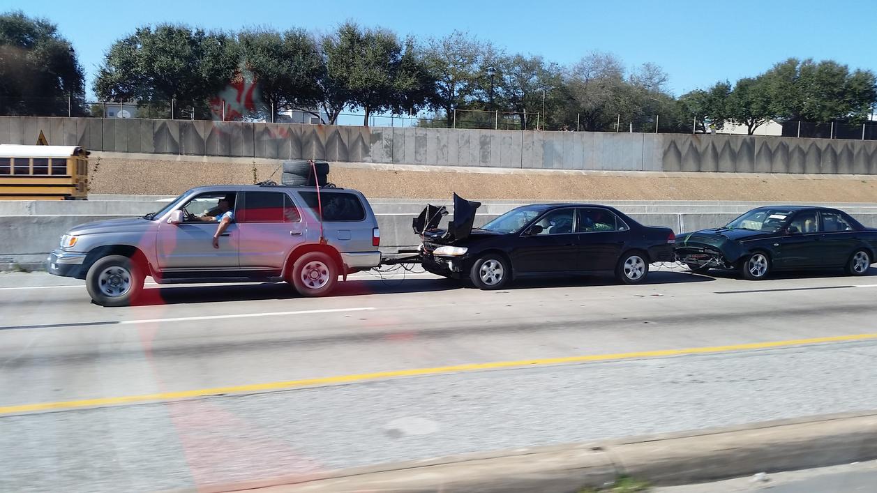

Sometimes I like to flat tow 2 or 3 sedans behind me. I like to pretend I'm an engineer (like the train driver kind). But I usually only do it in my 3rd gen with some tires stacked on the roof. They help with the aerodynamics.
Cool. Now lets see you do that up I-70. Seems plenty safe :bounce:
I wouldn't want to tow more than about 3000 lb behind a fifth gen. Small pop-up maybe with nothing in or on the truck except passengers.
For 5000 lbs or more get yourself a 2500 GMC with towing package. My GMC was the cats meow with a 21 foot fifth wheel travel trailer.
Back in the old days I towed a 4000 lb pop-up behind a '77 Pontiac Safari (350V8 Olds engine) with overload springs and auxiliary cooler.
In all cases trailer brakes a must have.
I shot that pic out the window on the interstate in Texas. I love Texas. I end up there a few times a year. Best food in America. If I lived there I'd die of heart disease. And I always see some sort of crazy going on on the roads. Believe it or not the 4runner was actually towing pretty nicely with the two cars behind it. I've towed my FJ40 on a car trailer behind my 3rd gen... once. No thanks. With a supercharger or turbo though - a 3rd gen probably pulls better than a 5th gen.
