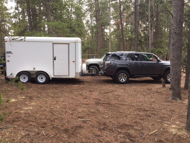

Mission: take boy scout trailer from Littleton to a camp above Conifer. I was "pinch towing" since our normal tow rig (Dodge Ram) was unavailable.
Payload: don't have an exact weight, but the last time the trailer was weighed with similar cargo it was over 3K. With the people and gear in the 4R itself, easily 3.5K.
Truck: My 2016 TE, with Airlift 1000 set at 20psi. Tekonsha P3 controller to operate the electric trailer brakes. I measured transmission pan temp and torque converter temp with OBD Fusion.
The rig (note the dual axles, which meant it was very stable):
On the trip up, it did great on C-470. Easily held 65-70mph with RPM hovering around 2500. But then once on Hwy 285 South, it got more difficult as you might expect. Transmission on S4. Had trouble keeping up with the traffic--also no surprise. At least it is 2 lanes on this part of 285. What worried me was TC temps. TC temps would spike on the steep pulls and then drop like a rock when the hill leveled out. As the drive progressed, TC temps kept climbing gradually until the spikes would hit 223. Any further than Conifer and I would have stopped to let it cool. I averaged 10 mpg for the trip up.
On the trip down, well that was easy. Braking no problem.
Now for my subjective conclusion: I would not want to do this up I-70 where the speeds and traffic are crazier and the steep pulls longer. I am very glad I was only going to Conifer. No way would I want to do this for long drives unless it was in the flatlands on, say, I-25 or I-70 East. I'll "pinch tow" for the scouts on the easier runs (which is a couple times per year).
I think Denver to Steamboat (a drive I have done dozens of times in various vehicles) with this payload would kill the 4R. Maybe even Denver to BV would be too much. My opinion is that pulling a 3500 lb trailer in the Colorado mountains with the 4R is a mistake. If you are going to haul this payload even a few times a year, get a better rig for it. You go to the mountains to relax and have fun. Why add the worry? If you keep the 4R there's always tent camping. :biggrin2:
