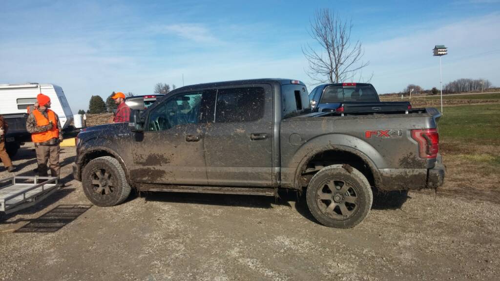

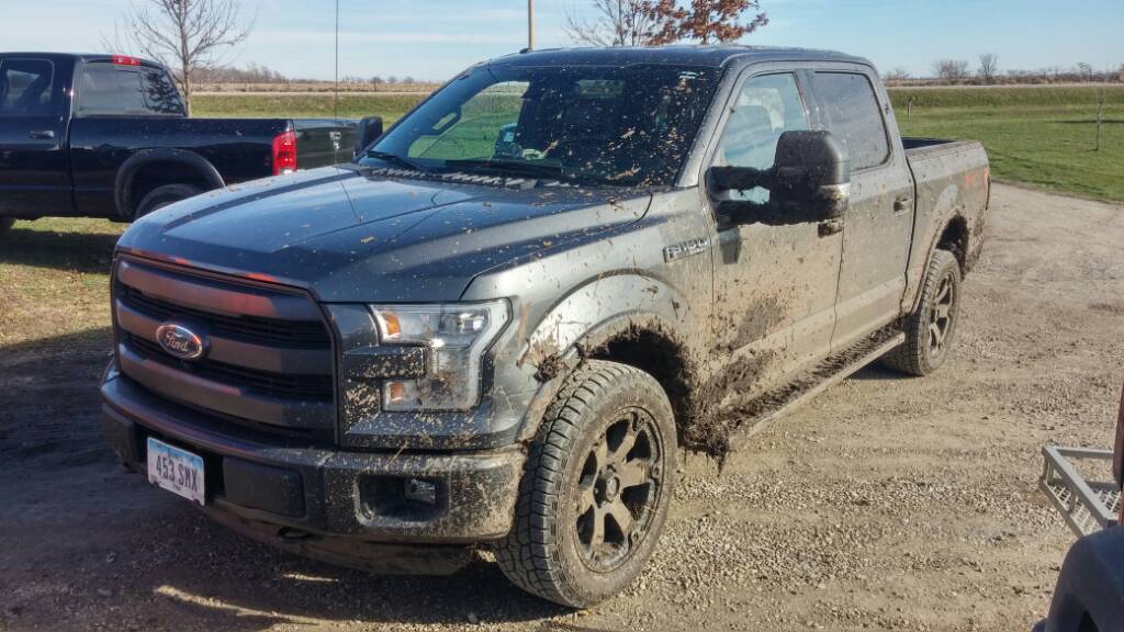

In regards to the Ford. . .the snatch strap was too thick and could not fit between the lower fasica/front bumper/and tow hook. . .so I had to slide in the D (:wink2: ) so that I could actually hook up to his vehicle. Also I have two others on the front of my bumper for recovery points as well.
You would be surprised on modern vehicles the lack of accessibility for hooking up on the front end and this was on a truck. For this scenario I couldn't attach to the back of the truck as he could not be reached from that side. He had to be attached from the front and pulled uphill
So for clarification it was stuck vehicle(Ford with D-shackle through tow point) connected with a snatch strap to my vehicle(Toyota with a d-ring on my hitch receiver)
