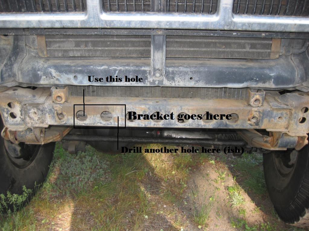

I also flat towed my '87 4runner with my 2002 Montero Limited no problems at all, i bought my tow bar at HF and it came with the plates to use as washers and make the crossmember a bit stronger than it is, i also had to drill 2 extra holes to fit the tow bar on the truck.
Where in the crossmember did you mount it (in the pic above)?
I'm thinking the guy I talked to was using those two holes in the member beneath the tranny cooler. If the brackets had multiple holes to use, I could almost use what's already there in the lower cross member there. I'm not super keen on drilling into things...
if anyone has pics of their brackets for tow bar mounted, I would be eternally grateful.
Check out this pic, this is how the tow bar mounts to the truck you're towing.
The two holes in the backplate will bolt to the crossmember of the 4Runner. One will go through the outermost existing hole on the crossmember, the other will go through another hole that you'll drill through the crossmember in the right location. On my tow bar, that was almost exactly between two existing holes, but for you it'll depend on your mounting bracket. Or if you're feeling spiffy, fab up a chunk of plate that bolts to the crossmember where the stock bumper brackets go, and weld the tow bar brackets to that so they sit out a little wider and give better lateral security. Any way you choose, you'll figure it out.
You will want some giant fender washers at the least, and better yet a couple chunks of 1/8th" steel the length and width of your brackets, drilled to match the bolt holes on the bracket, to use as a washer on the backside of the crossmember.

scary. I wouldn't trust that mounting. that cross-member is very thin.
id want it mounted at least out on the original bumper mounts, but even then...sketchy.
Ideally I'd want the brackets tied directly to the frame rails, but that's probably more fab than the OP wants to do in his seller's driveway.
My old '86 was dragged from Utah to Oregon and back with the tow bar bolted to the crossmember. It'll work.
if it were me, Id make a plate that bolted to the bumper mounts & the outer hole on each side..(probably even make it wrap under to where the tow hooks mount)... make 1 Bolt go throuh the plate & bracket & weld the other side of the bracket to the plate....
If the seller can make the bracket for the T4R before you get there & has a welder your set.....
If your going to do it the way kid suggested, Id use 1/4 steel plate the whole length of the cross member on the inside..... Its worth the few extra $ it will cost to be sure it will make it home safe.

What about where the tow hooks/tie downs mount? There's two captured nuts I believe. Would that be sturdy enough? I too think about flat towing if we were to get a motorhome. As airdreams stated, what about making ur own brackets but using the tow hook mount?
If the OP is putting the first gen behind his third gen, UHaul won't rent to him. He could lie to them about what he's towing maybe, but then if something happens he's got all sorts of liability.
I wouldn't use just the tow hook bolts, that puts all the stress in shear which could lead to ugly things. I think the best solution would be a fabbed plate something like the 4xI crossmember plate, but a little wider, and braced. Bolt it to the bumper brackets and the outer hole, and then bolt/weld the tongue brackets to the plate, outside of the bumper brackets for optimal triangularization. If you wanted to make it super-beefy, you could wrap it underneath and behind the crossmember with a couple bolts through the whole thing, but I honestly think that'd be overkill.
