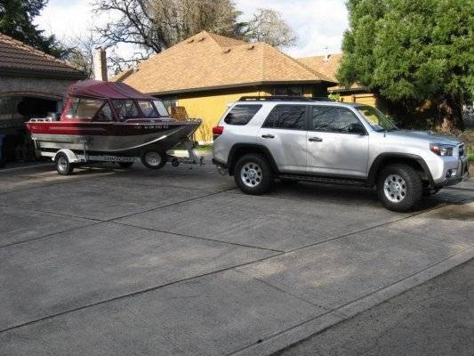

Wow, some of you guys are sure more willing to tow some pretty heavy trailers with your 4Runner than me. I've towed trailers plenty so no problems there but I've never been impressed with the way my 2011 Trail tows. I do have "E" rated Goodyear Wrangler Duratracs on it in stock size and Bilstein 5100 fronts/5160's in the back but no other mods.
I tow my 17' aluminum boat a lot - its right at 2700-2800 lbs depending on what I have in it for fishing/crabbing. Thats about all I really like to tow, maybe go to a little more than 3000lbs but more than that going over mountains isn't the most fun. I've been shopping for a camping trailer but not sure I would feel comfortable towing 4k+ with my 4Runner - thats me though. Good to hear you can actually get away with towing more weight.
