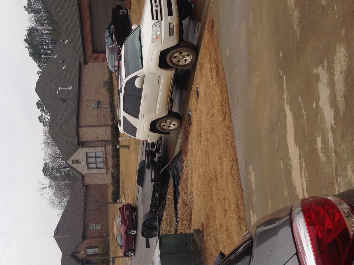

Here is the setup.

My recommendation would be to use the dually. Edmunds says 7,000 lb towing capacity but I think that's really pushing it with a 4500lb vehicle. Think about what all that weight does to your brakes and transmission, especially in heavy traffic (are you passing through ATL?)
I think you CAN do it, but if it was me and I had a more suitable tow vehicle available, I'd take that. Consider that the Dually has bigger tires, bigger brakes, and a longer wheelbase, all of which make it a better tow vehicle.
what kind of hills will you encounter?
personally, I wouldn't even consider doing it with brakes only on one axle.
also, don't load the truck too far back, you need that weight on the tongue, otherwise it will sway badly, and could cause you to lose control.
I say if you have a dually/fullsize available, you should just use that and don't take chances with the 4runner.

Pulling that load, the 4runner might get 4-5mpg. Use the 1 ton. It won't be any more expensive, be much safer, and much less hassle.
You are going to need at least 700lbs of tongue weight to keep that thing from tipping your 4runner over, so you'll be riding on the bump stops the whole way. The 7K tow rating requires a WD hitch setup, and is optimistic.
