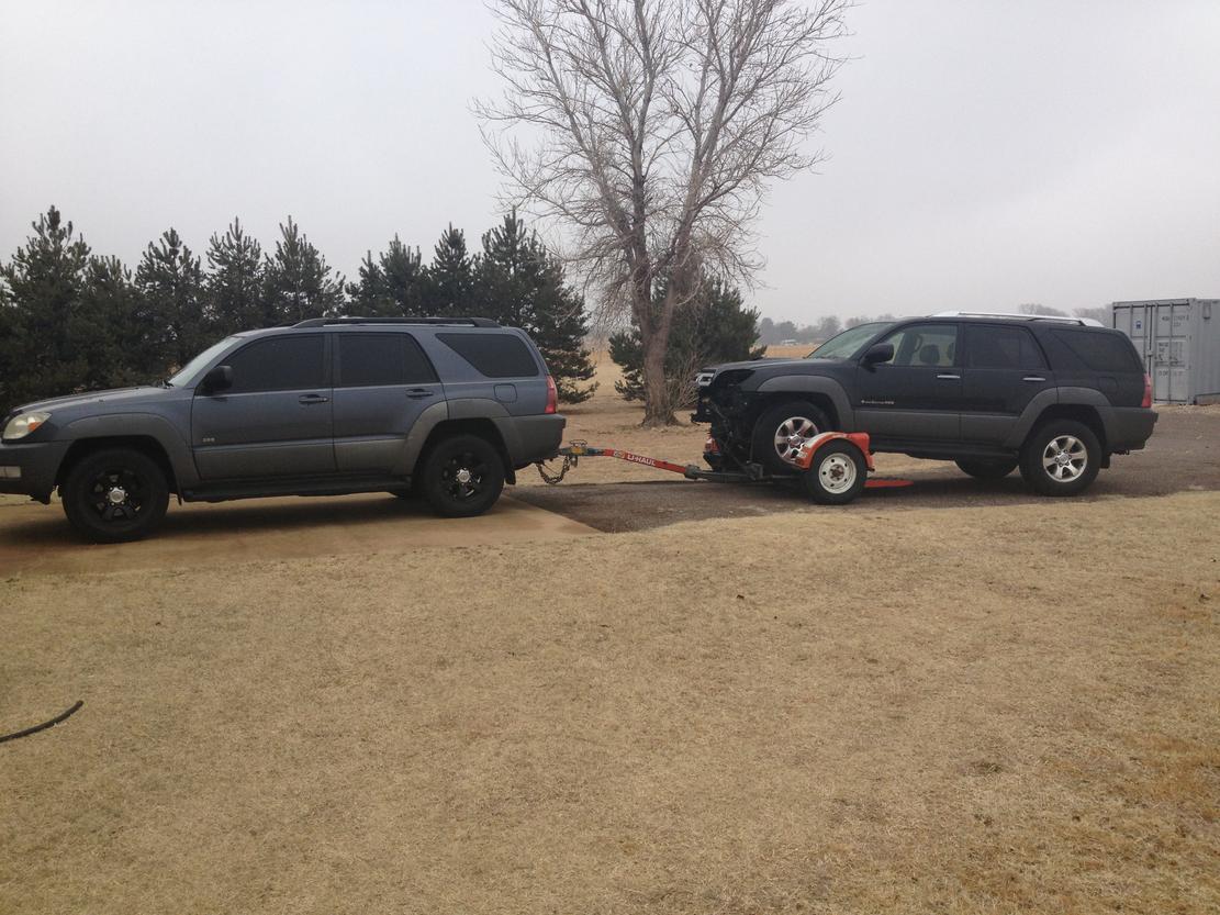

If it were me I would have rented a tow dolly, one way rental. I just pulled #3, 2003 black Sport, with #2, 2003 blue SR5, and had no problems. #2 has the engine and transmission from #1, 2003 black Sport and currently has more than 185,000 on it. Pull the drive shaft and go.
Of course they all are V8’s!!

Why did you go with a dolly rather than a trailer? When I drove from Florida to Pennsylvania, I got a quote for a dolly for like 130 or 180 for a trailer, and thats some wear and tear savings. I guess it depends on the distance you were traveling.
in some cases the dolly removes a significant amount of tongue weight, and also lowers the total amount of rolling weight

Besides reducing the weight, you also reduce the wind drag. A high profile SUV on top of a trailer catches a lot of air, especially in a crosswind. In Oklahoma it’s always windy! I’ve pulled things on trailers before and it feels like your pulling a parachute.
With the wind resistance, here was my thinking. The SUV is designed with aerodynamics in mind, and by putting it on a dolly, you're exposing the undercarriage to a significant amount of direct wind, leading to some parasitic drag and such. But i'm sure the trailer probably creates a lot of wind eddies as it is which negate that....
I've always just blindly thought "save wear and tear." I have not been looking at the whole equation obviously.
That's my issue. I don't like the extra wear and tear on the rear end. Plus, I had stuff loaded in the bed and 35's are not Uhaul strap friendly!
