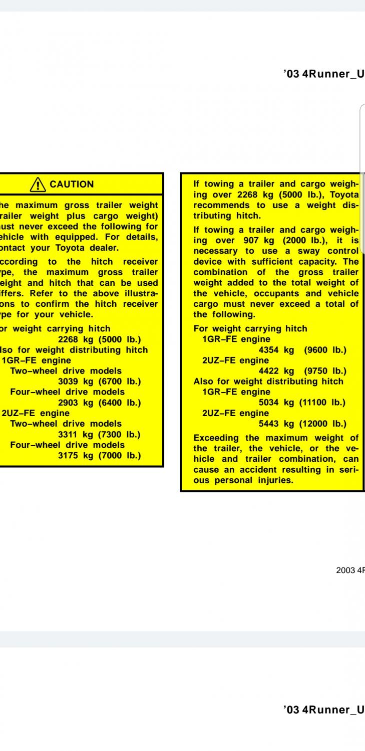

AFAIK, the 5000lbs tow rating on the 2003s are for "dummy proof" purposes. That's the lowest, most conservative rating for the V6. When you look at the user manual for the 2003s, it clearly indicates that the V8 with Class 3 hitch has a much higher capacity than 5000 lbs.
However, due to the fact that most newer SUVs in the market now are using the towing capacity as one of their main selling points (VW Toureg, Dodge Durango, Nissan Pathfinder Armada are all listed at 7000+lbs with "proper equipment" installed), that's why Toyota decides to advertise the 4Runner in the same regard, BUT with restrictions outlining the hardware requirement.

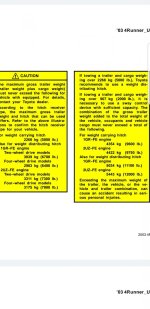

I have the OE V8 hitch on my car and here are the load limits:

Remove the spare and a standard hitch will work fine. It's a tight fit in there so with the spare in place, you need a shorter hitch. Not that big of a deal. The factory hitch receiver is rated for 7500 lbs if a recall, I wouldn't call it worthless. It's bolted to the frame with either 4 or 6 bolts, I forget exactly. The frame is built very beefy back there and is more than capable of handling the towing capacity.
