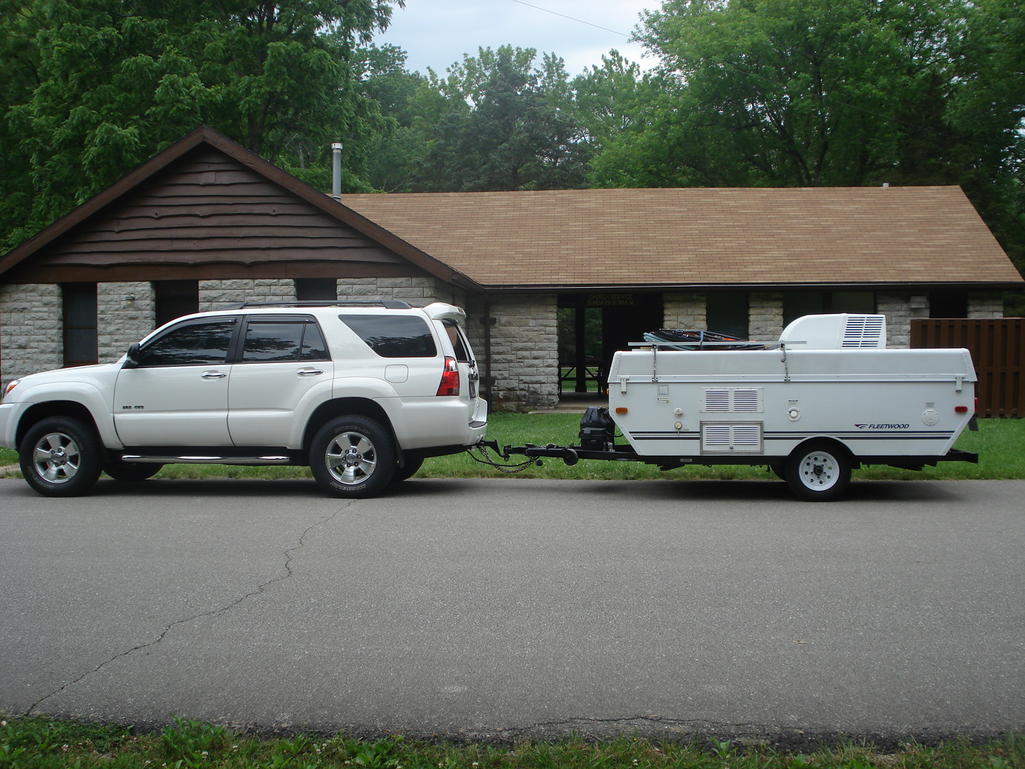

I just made my 1st trip this weekend also.
I have a small pop-up that weighs about 1500-1600lbs loaded.
Everything seemed to pull nicely, plenty of power with the V6 in 4th gear.
I do notice if I hit a stretch of highway with a certain frequency of bumps, I'll get a little wave action going. The Bilstein 5100's are a little stiff, but dampen things out nicely.
I was thinking of talking with my trailer place to see if a WDH would settle me down completely even though it's over kill for this weight.
I am planning a trip to California next year and want it to ride nice.
Anyone running a pop up with WDH?

Friend of mine had one and he told me it made the ride more comfortable. He had a smaller truck though, an Escape v6.
The WDH will spread the force when you hit a bump and reduce the bouncing effect. No need to buy a fancy product, you can probably find one used on the web for less than 200$.
Hope you had fun over the weekend!

I have a question for you.
While towing our popup my son tells me that he is bouncing around some in the back seat. I dont notice it in the drivers seat. The wife swapped with him once and she said he was right you notice it more in the back seat.
Its a Niagara pop up so I think its a 16 foot box 19 foot over all. I swapped out all the springs and stuff from a FJ and it sill does it. Weight issue?
I would think with the added load it would be a softer ride actually. Unless there is too much weight in the back, then stiffer springs would fix that.

I called my towing place today, they have been in business 50 years and have always been right on the money.
They are saying we will try to lower the tongue by about 2" below level to add tongue weight. Hopefully that will help with the bounce. I did that with the same trailer on my Tacoma and it helps a lot.
I could only find a 5 1/4' drop at Wally Mart. That put me about level with my lift.
He has a 6" and 8" drop bar I will try hopefully this week.
The problem with pop-up campers is that you don't have enough tongue weight to get any benefit from a WDH. You have to have at least 400lbs of tongue weight for a WDH to work and then you have to have the strength in your pop up to apply the WDH.
Loading gear towards the front of the camper will also add tongue weight. Need to measure loaded as if you were going on a trip.
Anyways, try running the tongue below level by 1-2 inches and see if that helps. You can google how to measure tongue weight using a bathroom scale and devide by 3. Once I get mine set up, I'll post about where we came out with tongue weight. I am guessing I'll need around 300lbs.
