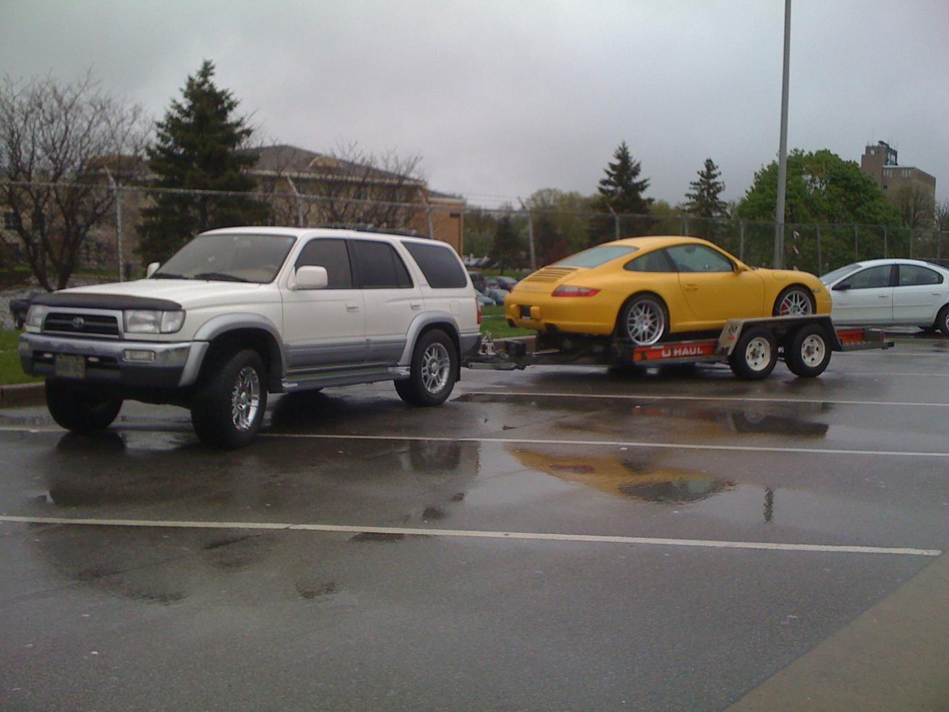

I Have towed at the limit though. Couple hundred miles without issue.
Rear squatted as you can see. Gas mileage wasn't too bad either.
Trailer had surge brakes. take off was slow but it did it okay.
