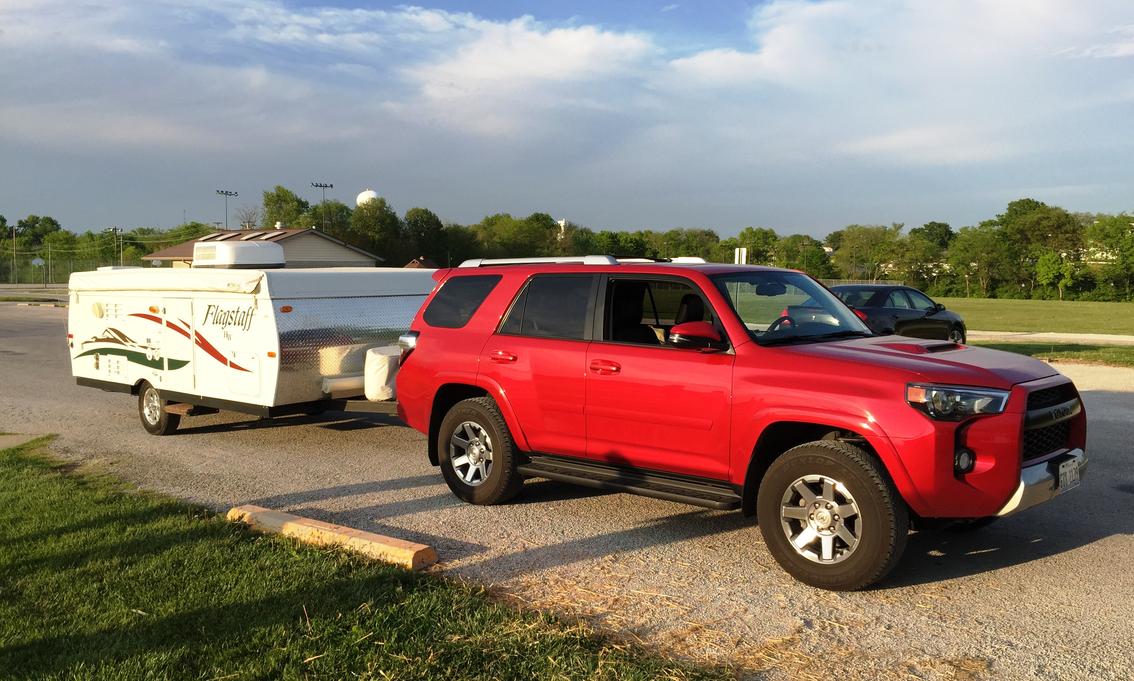

Congrats on the HW. We have the same model. Now, I'm all stock, but it does do a considerable squat when loaded and hooked up. I'll be installing airbags soon to compensate. I also have a friction sway device, but it was mainly for cheap insurance, as it stays planted and straight behind the truck.
The pop up tows great. I keep my speed between 65-68 and I still average 17 mpg.
Grant
