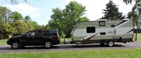

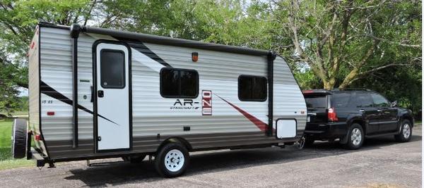

Here's some pictures of the rig:

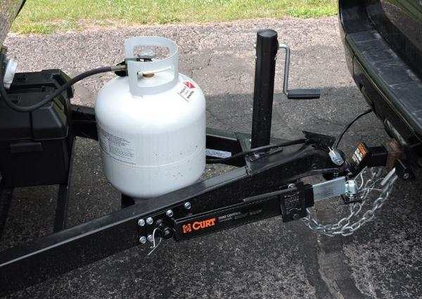

Here's a picture of the hitch with the Curt sway control that I installed:
The Curt unit comes with a plate that is bolted to the side of the trailer tongue that contains a small ball for connecting one end of the sway control. The other end is connected to a second small ball which resides on the side of the draw bar. A steel plate is provided with the kit which can be welded to your existing draw bar or you can buy a draw bar with the plate already welded to it from Curt and others. Everything that you need is included in the kit. I installed it in a less than an hour.

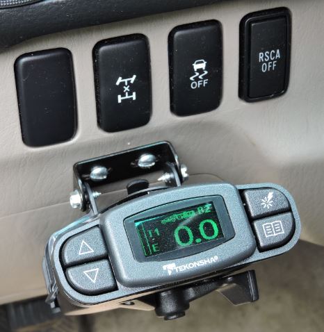

Here's a picture of the brake controller install:
I installed the brake controller just above the fuse access cover and ran the cable for it through the hole in the access cover. I used the quick release mount for the P3. This was about the cleanest install I could come up with. The controller pops off and lives in its case in the center console when not in use and the cable tucks back into the access cover.
Approximately 70% of the trip was highway and the trailer happily followed along at 60-65 MPH with no issues. Weather was mild with no significant wind. No significant semi passing drama either. The trailer settled in and went were the truck went. I only held the transmission in 4th gear for the occasional long hill. Other than that the truck found its way to 5th gear normally and happily cruised along.
On the way out my freshwater tank (26 gallons) was about 1/3 full, black was about 1/3, and grey was empty. On the way back all tanks were empty. I didn't notice any significant difference in towing. At some point in the near future I will install the aforementioned air bags.
The towing mirrors that I used were the Tow-n-See units (Tow-n-See). They worked well. No issues.
All in all a great trip. Truck and trailer performed well. We will be doing this a lot more! : )
