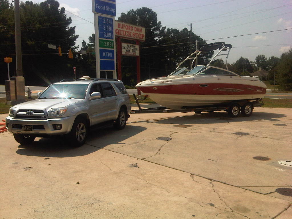

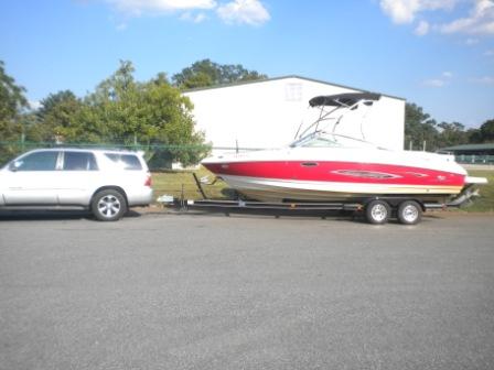

I recently purchased a 2006 Chaparral 246 SSI and am towing it a few miles from storage to the lake in N. GA a couple of times per week. The boat is about 6300 lbs w/ the tandem axle trailer. I am towing it with an 06 4Runner LTD V8 w/ 63k miles on it (and the original shocks).
I am getting about 3 inches or so of sag with the boat on the factory class IV hitch (rated at 7300 lbs).
I have not figured out the tongue weight yet, but don't have any room to move the boat back on the trailer to reduce the tongue weight. The hitch insert is 'flipped up' so the ball is higher than the receiver itself. It is about level, aided by the attitude of tandem axle.
Does anyone have a suspension tip to help reduce the sag? ex. Bilstein HD shocks, an air suspension, etc ?

First, your T4R is 4Wd so it has 7000 lb towing capacity. The 2WD is 7300 lb. Don't forget to include the weight any fuel or equipment in the boat. Your best bet is a weight distribution hitch. It's cheaper & easier than suspension changes.
