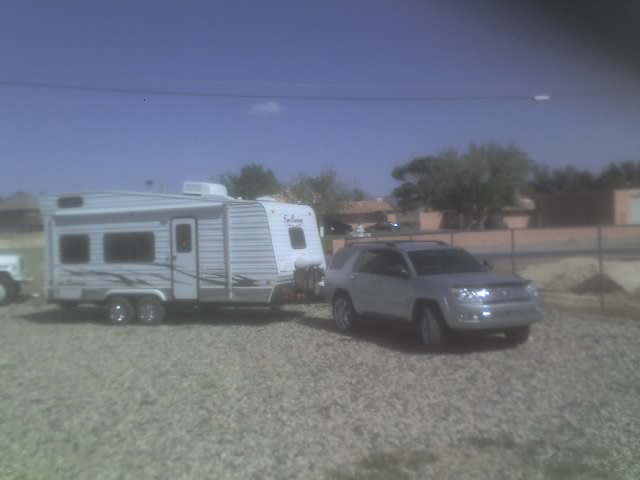

Well I towed over 5000 yesterday with the 4R. Below is a picture of the rig I towed. It towed like a CHAMP and I am extremely pleased with it! I only towed about 70 miles or so on pretty flat land but it definitely held up. Of course I had sway control and weight distribution. I hit some 40+ mph cross winds and it rocked the rig a little but it was not a white knuckle situation. The Prodigy is a sick brake controller and performs better than any I have ever used. The rig I was towing is a Carson FD-202 (20 footer) and I had water and a quad inside.
