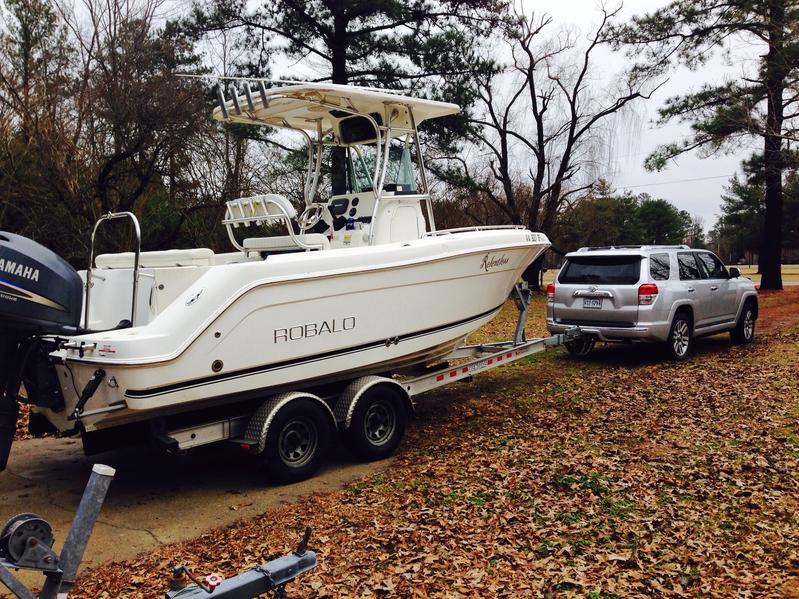

Got a new yellow tow capacity sticker for 6500 and it tows much better now.
That boat ^^ is sweeet.
