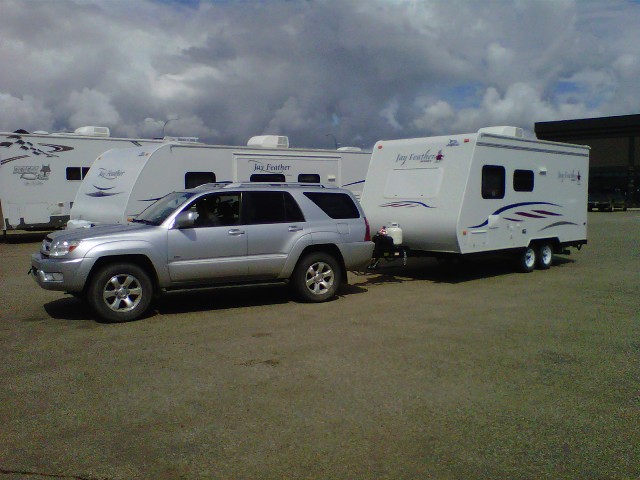

I just bought my first travel trailer last summer. Have towed it a few times ~1hr outside my City a few times and it tows it well.
Check your sticker but I beleive all v8 4x4 4Runners can tow 7000lbs, 7200lbs for 2wd. You'll need a WDH to do this. I didn't like the idea of maxing out my truck so my trailer's GVWR is 4200lbs. Being that this is the first time towing for me I can't compare much to others but my 4Runner towed the trailer well up the few hills we have around here. The one downfall is the physical size of the 4Runner, it's fairly small so cross winds can blow you around a bit. I've heard sway control hitches can fix this.
Just watch your trailer weight, and decide on what's comfortable for you.
