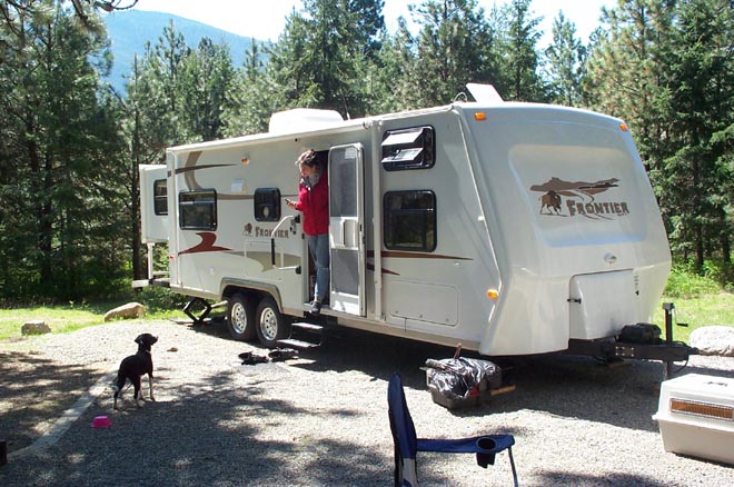

Nice rig cenewc - here's a pic of our new Frontier TT the day after we brought it home last week. Have the weight distribution installed, but still need to get the sway control system set up, and had new tires put on the 4R yesterday (Cooper Discoverer ATR). First roadtrip is scheduled for Memorial Day weekend to Kalispell, MT, only 200 miles so will be a good test run. We might take it out to a local State Park next weekend also.
BTW, are there any opinions out there on whether the stock trans cooler will be enough for a trailer of this size, or should I be looking into putting a larger one on?

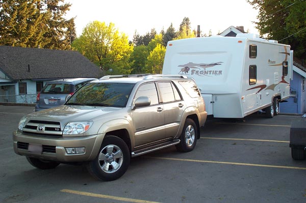

Here is a photo of my 4Runner connected to my travel trailer, a 2003 Kustom Koach, weighing about 4700 lbs on the wheels in towing mode. I towed it this past weekend in 28 C temperature and the gauge did not deviate from its non-towing position. Lots of torque with the V8. I have changed the factory hitch to a Hidden Hitch.

seh750 said:
Nice looking rig! What benefit does the Hidden Hitch provide that the factory hitch did not?
In short, more towing capacity depending on what hitch is currently on the 4Runner and drivetrain.
There are two different hitches for the 4Runner. The V6 comes with a weight carrying hitch (standard 2003-05, optional on 2006), good for 5000lbs for both 2WD and 4WD. The V8s now come with a weight distributing hitch, capable of 7000lbs for 4WD, 7300lbs for 2WD. The 2003 V8 came with a weight carrying hitch, thus some V8 owners upgraded. The weight carrying hitch has just a receiver mounted to the rear cross member. The weight distributing hitch is a tube hitch that's mounted to the rear cross member and the frame rails that runs the length of the 4Runner.
Not sure, but I thought I read later build 2003 V8s gotten the weight distributing hitch. However, a buddy of mine swears his SR5 V8 is a 2004, but he has the weight carrying hitch (V6 hitch, 5000lbs).
HiddenHitch makes two different hitches, #70411 good for 7000lbs and #70779 good for only 5000lbs. I'm told the 70411 has been discontinued. Both are tube hitches, but the 70411 is curvy like the factory V8 hitch and the 70779 tubes are straight.
