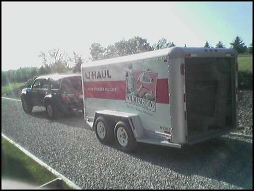

this was the first time my 4Runner had towed anything. it handled that trailer with ease!

Hey 4-Ruiner, what kind of gas mileage did you get when towing that trailer? That's about the size of a trailer I'll have to use soon on a 400-mile trip. I assume you've got the V-8?

Wow, 4-Ruiner has a 3rd generation 4Runner. That means he carried that big rig with a 183 HP V6 engine.:bonk:
hey atomic, i'm not sure what kind of milage i got towing that trailer b/c i only towed it about 35 miles.
and yes, i do have the monstrous V6 engine. 183hp and a mind-blowing 217ft-lbs of torque! haha.
