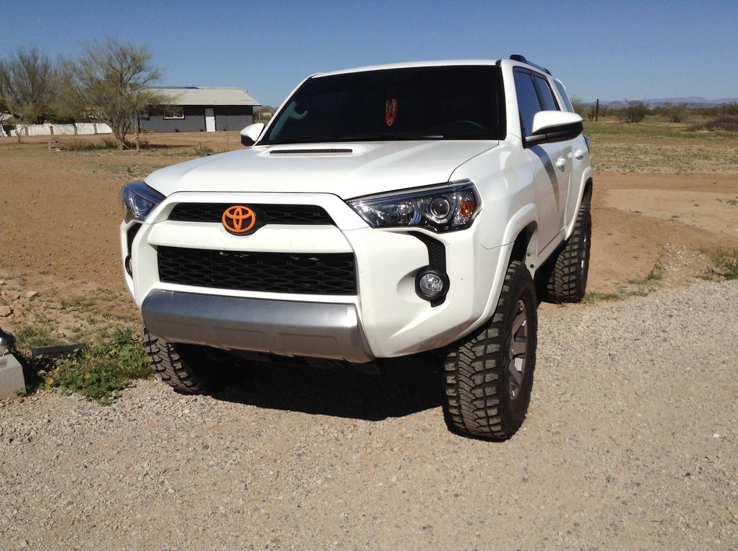

I have this kit on '15 with about 2,000 miles on it. Pretty happy with it. I used stock upper arms and got it to align, drive straight and wear tires evenly. I also did 1.25" wheel spacers until I get another set of wheels.
Looks great! Thanks for the feedback. I do have 1.25" spacers installed now. They were leftover from the Tacoma. ;)
