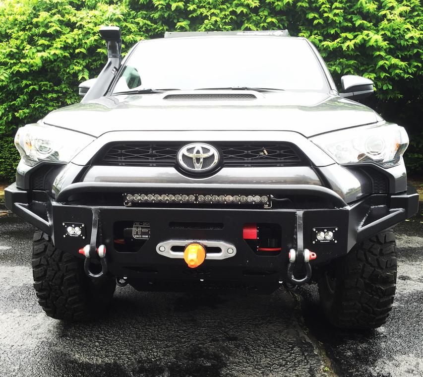

The day before Jamboree and I get the bumper, winch and lights on.
We are using the Hefty Fabworks Aluminum (59lbs) front bumper with a PRG 9k Winch, Baja Designs Stealth 20, two Squadren Pros, PRG synthetic winch line and a Factor55 Thimbol.
