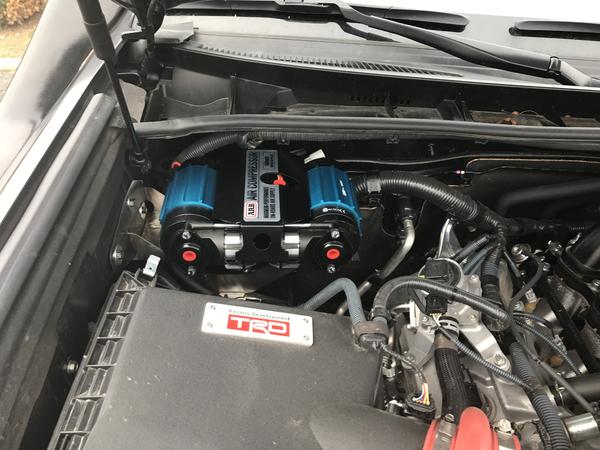

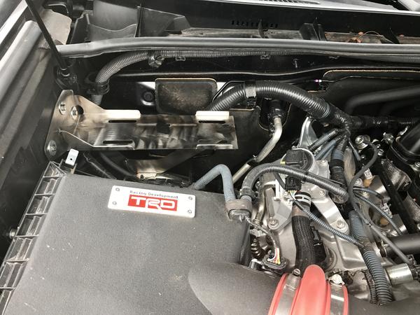

It's been a while since I updated anything. We have been very busy with the Tundra Build (will be in the Timberland SEMA Booth).

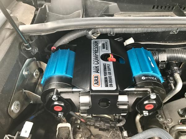

I just installed the new Hefty Fabworks ARB Compressor Mount (AVAIL HERE)
It takes about 5 min to install and give you a perfect spot for your compressor without having to make room.
The compressor tucks nicely into the corner like it belongs there.
close up
I put these up on our site for $105 Shipped, so you save about 10% after shipping off of retail.
