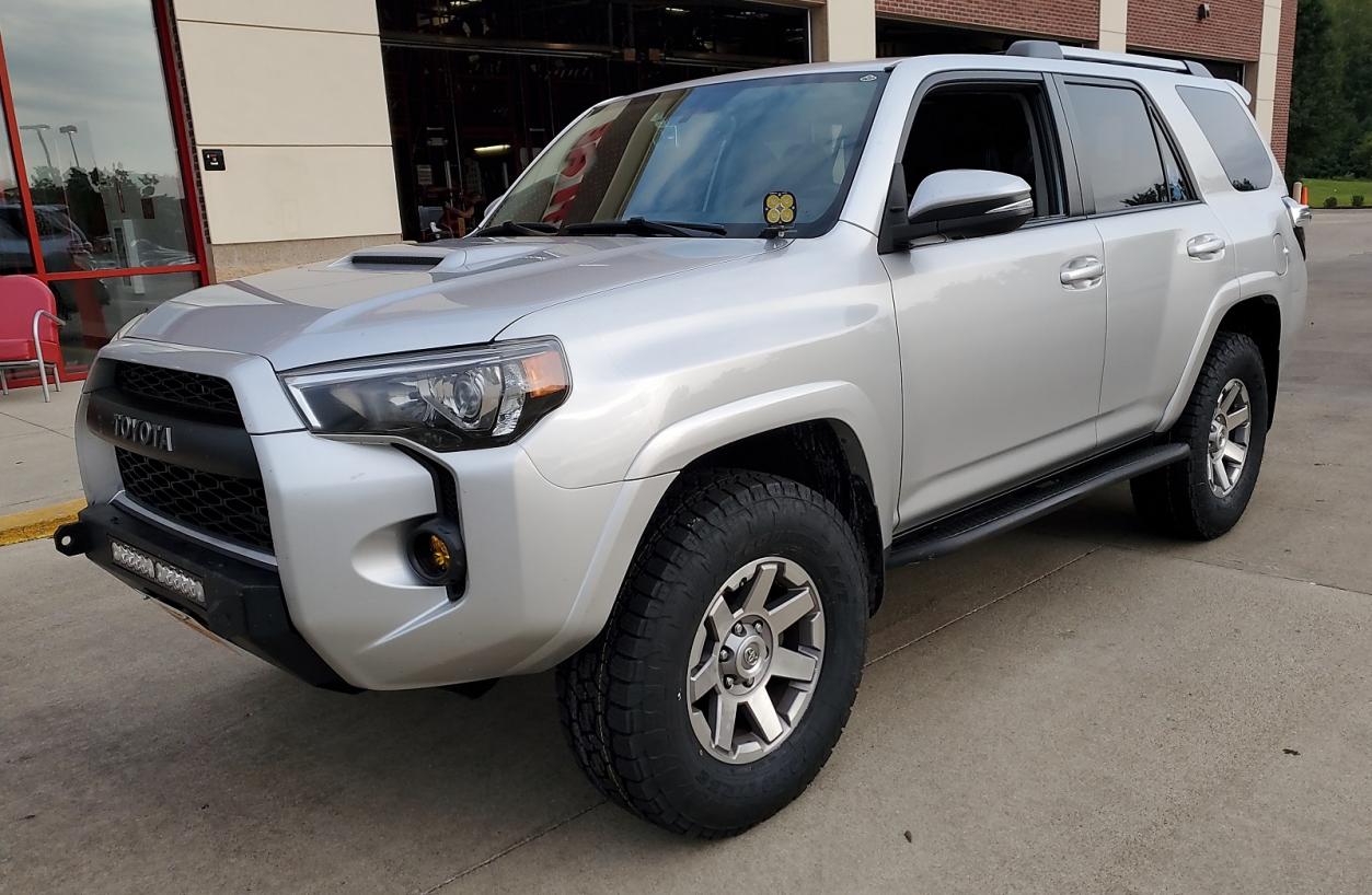

Just put a set on today. 265/70/17s SLs.
Too soon for objective data points. However, subjectively the AT IIIs look more aggressive than the previous version, and maybe a touch quieter. We'll be taking a trip out to Colorado towards the end of the month and will likely get them muddy and snowy.

Considering these myself in stock size P metric. They look pretty good on yours. I’ll be interested to hear your thoughts as you use them more. Please follow back up on this thread!

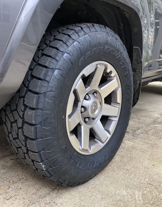

Got mine the other day in P285/70R17. I didn't realize how smooth going back to P would be over the LT C I had been running. My off-roading is limited, but the truck will still be the primary driver in the Rust Belt Winters.
There's some rubbing even with the lift (which is only about 2"). I trimmed about 1/2" off of the bumper on both sides and had to push the passenger side front wheel well liner forward too. The driver's side is rubbing a little on the mud flap. I don't want to cut the mud flap until I'm sure it's just the mud flap and not working on the body mount.

Take the flaps off as a test, if that clears the rub(my 285s did) I took a heat gun and molded the flaps back, they had about 3/4" play to melt them back.
