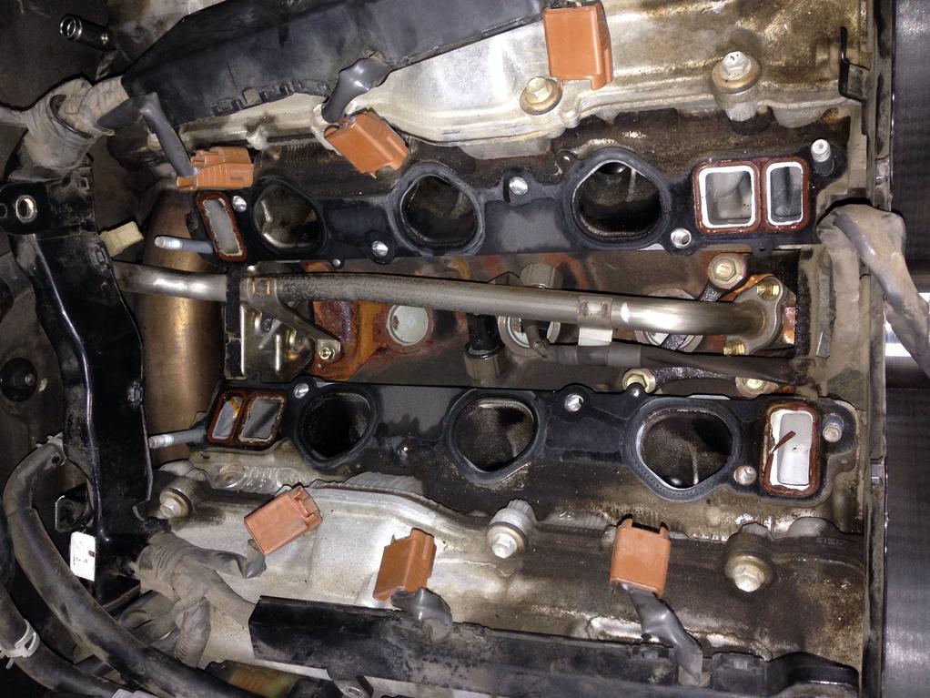

That makes things so much easier. Glad you know the difference, I was seriously considering telling you to just take your car in and get it done. (Cause I thought you didn't know the difference between the camshaft position sensor and knock sensors) The wire harness actually just comes up and out on the right-ish side of the water return line(I believe it's the return) on the intake manifold in between the metal plate and the intake manifold. I'll snap a pic real quick and upload it in 2 seconds.
You can see the harness running along the metal plate for the timing cover backing and under the water return line.
Took this pic looking down between the timing cover and next to the drivers side fuel rail.
Awesome! Yeah, those pic will help a lot. I'll prolly go buy all new gaskets tomorrow and button it all back up. Thanks for the help:)
No problem bud, good luck with the rest. Hope it all goes smoothly. Also, found this picture that shows a MUCH better view of when I pulled mine apart. This shows EXACTLY where factory routing is. Hope this helps out [MENTION=88740]TXRick[/MENTION]

Looks like you guys figured it out! there is a little chamfer in the intake manifold which makes space for the wire to squeeze through.
