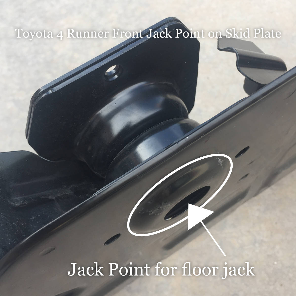

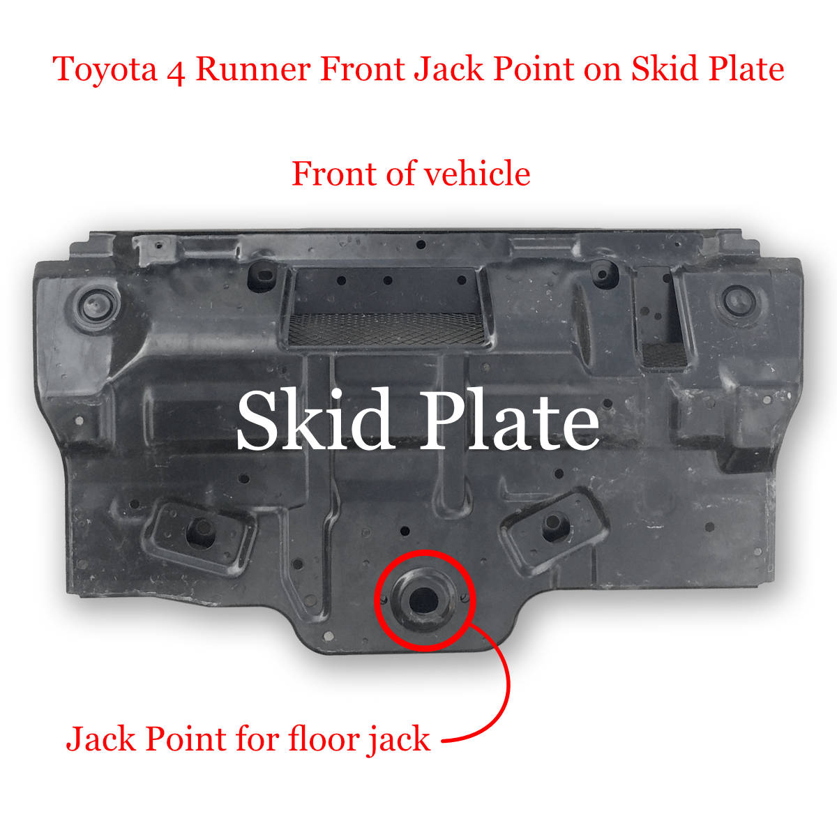

Hi,

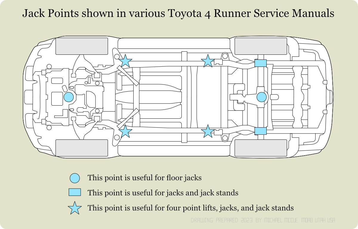

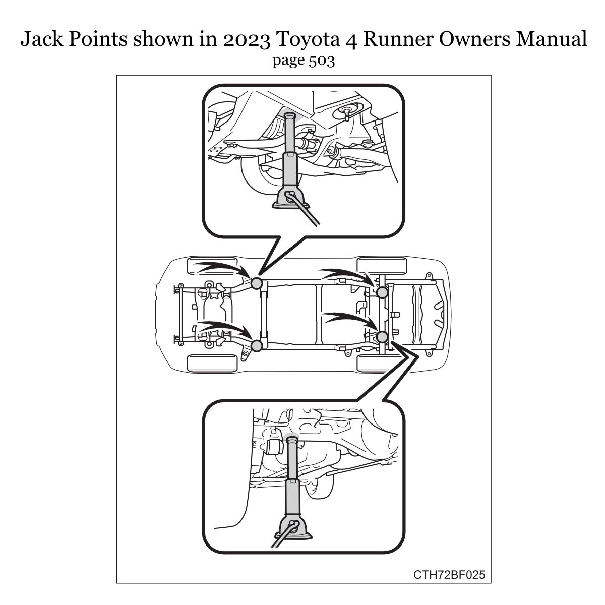

Here are some pictures that may help first-time 4 Runner owners, such as myself, learn where they may place a floor jack to raise the front of the vehicle for general maintenance etc.
The pictures show the skid plate and the jack point on my 2023 5th Gen 4 Runner TRD Off Road Premium.

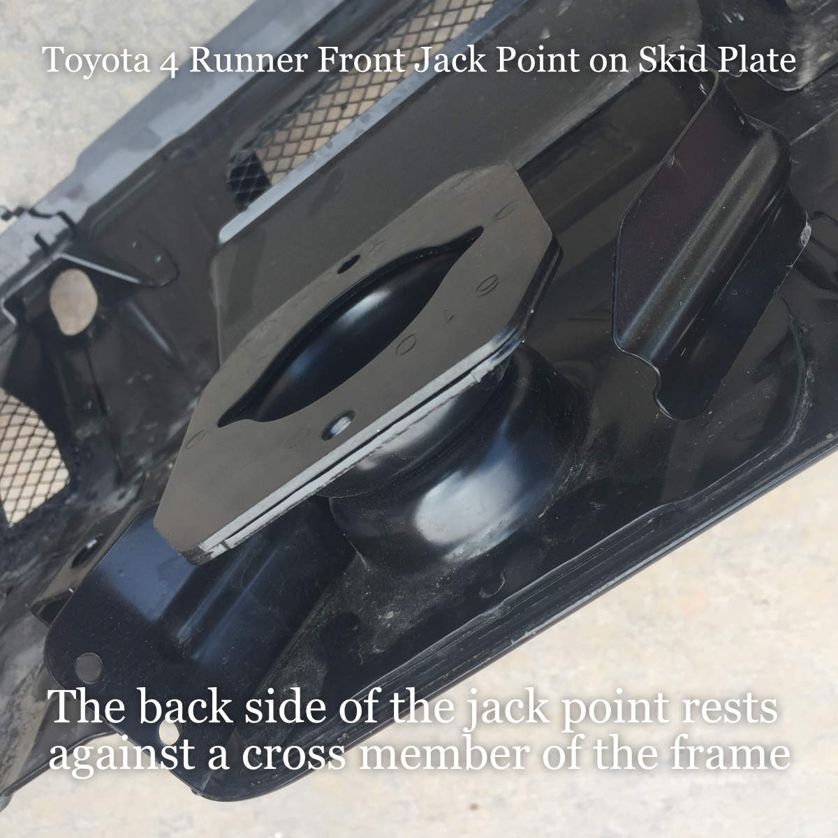

I had asked and learned about this a few weeks ago, so when I finally did my first oil change I used the occasion to make a few photographs that show how the jack point is reinforced and how the structure fits against the frame.
I forgot to make a picture of the frame's cross member, but it is there right on top of the jack point, so when raising the jack right underneath the circle shape you will effectively be lifting the front of the 4 Runner as if you were jacking on the frame.

Thank you. I kept seeing the diagram of the front center jack point but that is not in my 2011 owners manual. Good to know I can jack it up there.
