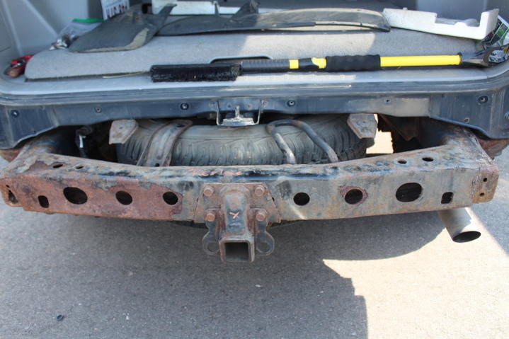

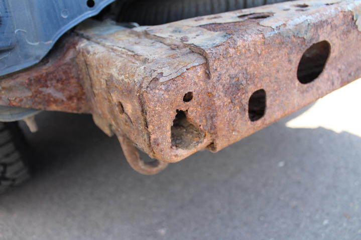

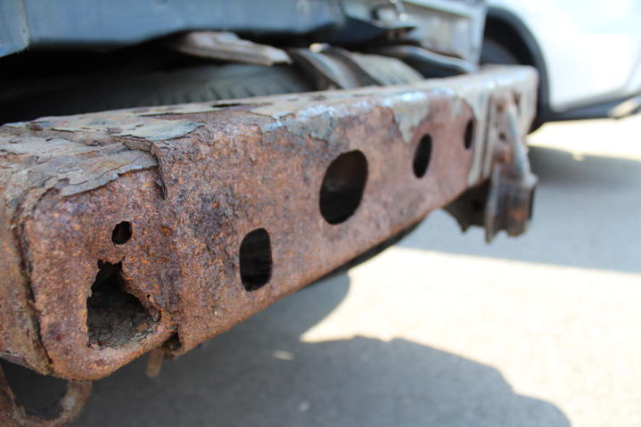

Here's pictures of my frame. Sadly it appears my T4R is on it's way to being totaled because of a rear end collision.

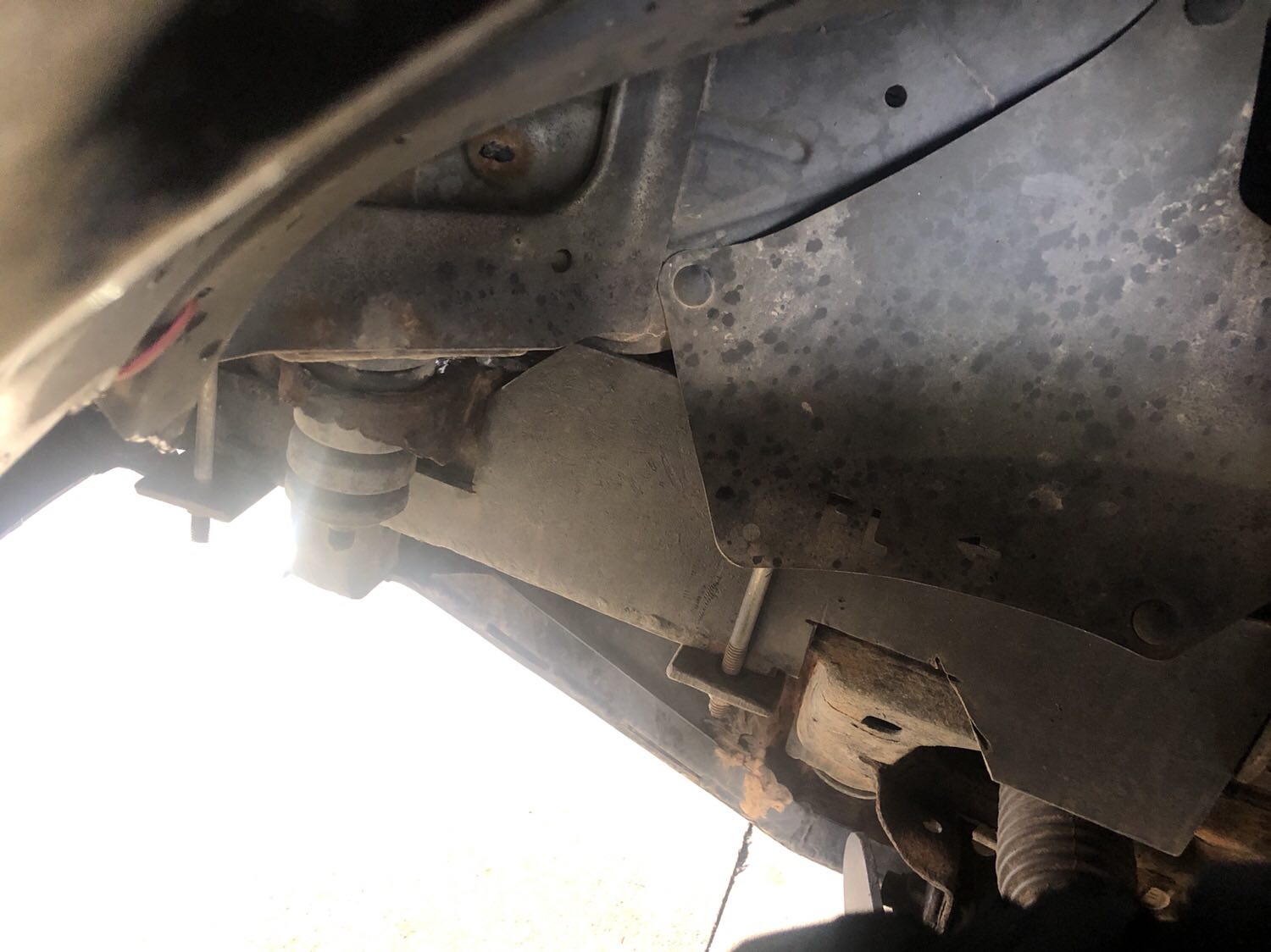

We cut off the worthless rad support and made 3/16” sleeves for the front of my frame rails. There wasn’t any steel left on the front of the frame wells to weld plates onto for reinforcement IMG_0997.JPG

Pretty sure they have salvaged steel from shipwrecks under the ocean that have looked better.
