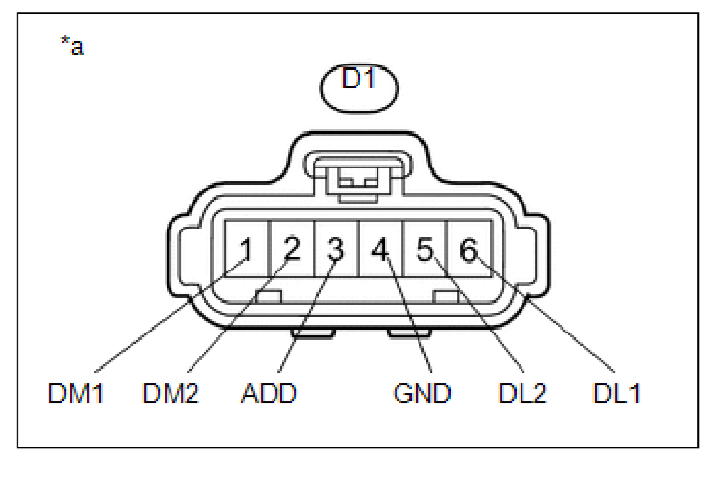

I’m curious what else goes into engaging ADD. There are 6 prongs (including ground) in the connecting harness.

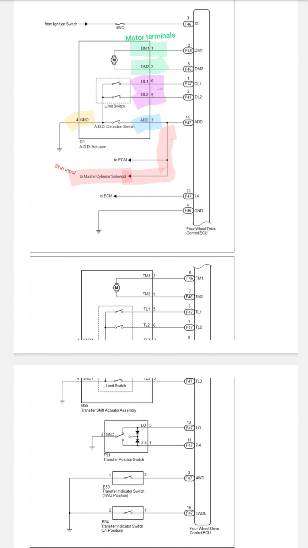

Yes correct. Your four wheel drive is functional without the skid ECU/master solenoid. But are your VSC and other abs related functions all working when the ADD module isn't? "(Toyota said the signal being passed to ADD wasn’t being read)" and the technician tested the entire circuit to pinpoint the failure point? By chance do you know if he tested the new ADD module before installation? Battery voltage alone will fry it. Here is the circuit and connector diagram attached. I reckon you could bust a multimeter out and and test the circuit and communication between modules.. Did you keep your old module? With some skill and knowledge you can open it up and inspect all the contacts and switches. Sometimes a good cleaning is the only thing wrong with it. You can also hook it up to a power source with the PROPER relay and test it yourself, Toyota won't do this though they will only replace it.
That diagram is golden. I don’t think Toyota tested it like that. All the tech did was order and install a new one and see if 4wd worked. Good because it’s speedy but bad because the issue appears to be more than just an ADD failure. I wish I asked for the old actuator, but I never did. I’d be curious to test it myself.
I am curious what they meant by "the signal isn't reaching the ADD," because that makes it sound like a 4WD Module issue or a wiring harness issue not sending a signal to the ADD? Which seems a bit odd to me, but I suppose is possible?
I have had to de-pin... I want to say pin#3 on the ADD and either leave it open or ground it to diagnose whether or not an issue was ADD related or not. But aside from the actual motor being driven, everything else on the connector should be an Output not an Input as it's feeding signals back to the 4WD ECU on the status and position of the actuator once it's been commanded to engage/disengage.

I back that. The only input at add is command to operate the motor. Maybe he said it backwards that would make a lot more sense. Or maybe he just needed to bash it with a hammer first and then check for signal to the motor well that's where I would start your diagnostic is at that connector. And this technician has f_cked with that connector that should normally never even be touched over the entire lifespan of the truck numerous times now so maybe you'll get lucky and find a pin pushed in too far or something simple like that. Don't forget to ensure good ground. This is why you test the basics first instead of replacing a module three times one after another.. those odds are astronomical..
