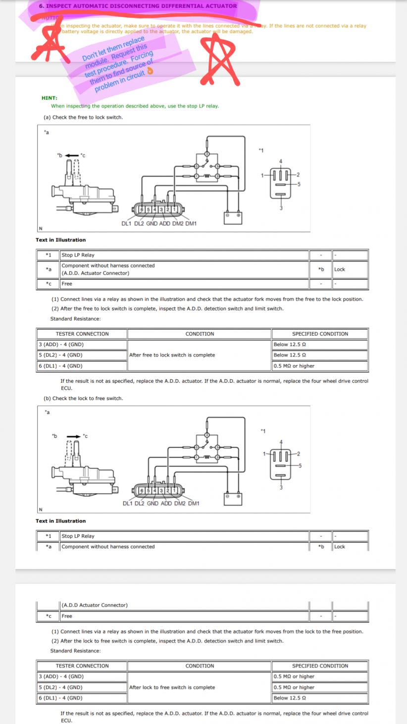

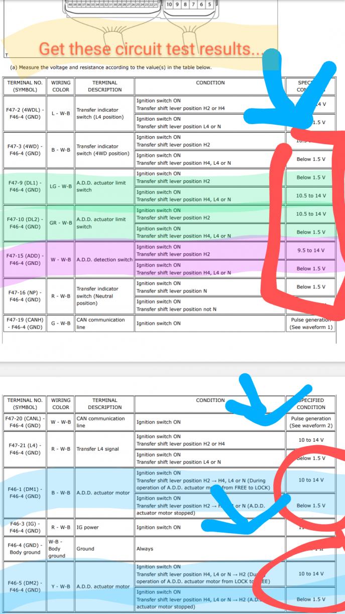

Give me a little bit I'm going to find and attach diagnostic information you need to understand and request from these f_cks before you go in there. KNOW YOUR Sh1t!!
I'm saying it's a unique issue and I haven't run into it... at this point without having your vehicle at my shop to do the testing myself and relay that to maybe TAS or my FTS... I can't really say where the original issue is unfortunately, all I can do is speculate based on "heresay" from you and the dealership and hope that my diagnostic intuition is correct. :/
Based on him giving specific details and requesting proper diagnostics as I mentioned before... Hopefully they can do a proper diagnosis. I'm going to attach the information he should be getting from a dealership technician :hatsoff:

Right this confirms that there is communication error between ADD and skid ECU. Remember the circuit?? ADD module is a skid ECU input. You're skid/abs functions such as MTS will be disabled but 4wd is still functional when the skid ECU can't receive ADD module signal. Make sure to relay this symptom to the flow chart following, wannabe tech. My issue was caused because I neglected to zero point calibrate immediately after lift. Yaw/g spot sensor detects lean in cornering and acceleration/de acceleration. A little 3" lift is enough elevation change to make that g spot go crazy! (EBD) You should have seen the codes I got ! The whole brake booster assembly, accumulator, and master cylinder "needed replaced" after this nearly killed a grandma off a simple sensor signal malfunction. The point is major codes come from little issues 90%
Here are the diagnostics that shall be done to test the module/motor itself. The other sheet is the diagnostic to test the circuit between ADD, 4wd ECU, and skid ECU communication. Get yourself familiar with this information and understand the processes. The technician can't bullsh1t facts and knowledge
